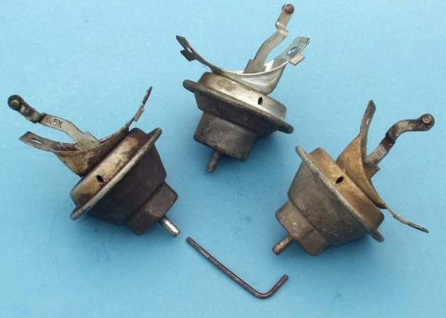

Is your vacuum pod the dajustable type? (hex shaped end)
Try sticking a 3/32 (?) allen wrench up the hose opening to adjust the spring tension.

I thought all vacuum advance cans where adjustable? The stock replacement I got from my local parts store is...even says in the instructions how to do it. You can use different springs from about any mopar distributer.

vac pod regulation= clockwise softens the spring (you need to do that)
CCW hardens the spring. Lighten all the way long the spring and then see if light throttle pinging occurs. If so, stiffen it like 1 or 2 CCW turns each time.
Many of the electronic ('73-up) vacuum advances are adjustable, but most of the points type ('72-down) units aren't. The end of the pull rod is different on the two types of advance, but you can sometimes drill another hole in the breaker plate to allow the use of the later (more adjustable, more available) advance units. Most of the pickup plates in '73-up distributors have two holes, so the later distributors can actually use early or late advance cans.
Dan, I'm probably just lucky, but I haven't encountered a vacuum advance that wasn't adjustable, points or electronic. I know they're out there (unadjustable), but what's the chance of that? Dozens, and most have been points type distributors. I suppose a lot of them could have been replacement pieces.

I haven't run into a nonadjustable vac can in my life neither. Guess we're just lucky. Even the old units that had the connection 90° from tip that I ran into were adjustable ones.
