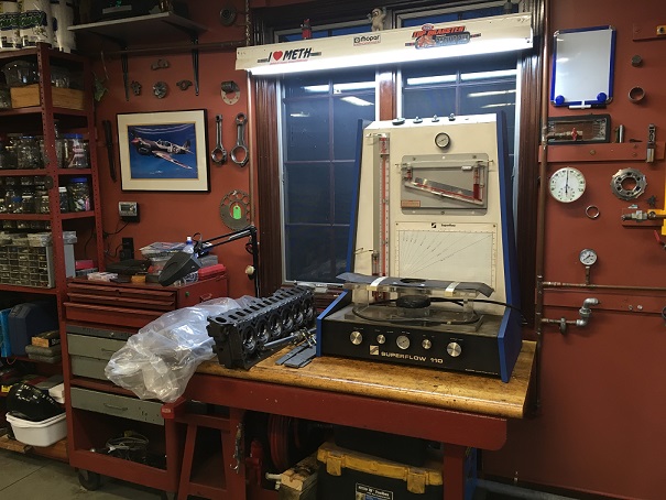

As mentioned by Dennis S, Mike J's flow bench is now in Indy.
