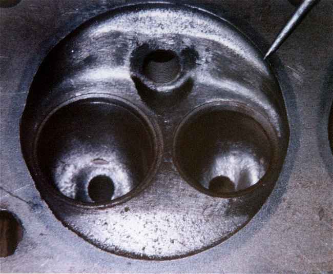

Got a dremel, so that's easy. I'd do either a single cut and have the ground electrode protrude over the center electrode by about 1/3.
Or a tapered cut (3 dremel cuts) and have the ground electrode over the center by about 1/2.
Then have the gap at about .042 instead of the .045 I'd run without cutting the electrode (there's less electrode to wear away, so just a little tighter to compensate)
From looking at the combustion chamber
I'd think the ground electrode should be somewhere in the semi-circle that's on the head (roughly a 90 degree wedge as good).
And the place to avoid having the ground electrode would be directly opposite the good area (the 90 degree wedge next to the piston)
With 6 plugs and 6 combustion chambers I'd think you should be able to at least avoid the bad area.....

EMSVITIL mentioned a good area for the electrode being "somewhere in the semi-circle that's on the head (roughly a 90 degree wedge as good).
And the place to avoid having the ground electrode would be directly opposite the good area (the 90 degree wedge next to the piston) "
Looking at his photo of the chamber, I guess his "good" area is the raised area between the valve seats. Though it seems to me that would shroud the spark to some infinitesimal degree.
The part of that post that REALLY left me scratching my head was about cutting the electrode with a Dremel tool. "I'd do either a single cut and have the ground electrode protrude over the center electrode by about 1/3.
I'd like to SEE that, as I can't seem to visualize it. Got pics???
With the ground electrode in the semi-circular area of the head, I think this would minimize shrouding (at least on a slant-6 head)
