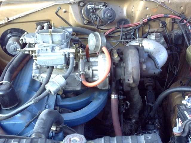

:D
http://www.cardomain.com/id/lncognito
PostPosted: Sun Apr 30, 2006 9:27 am
Posts: 3740
Location: Sonoma, Calif.
And the one I currently working on.

as i continue work on my turbo project...pitures are inspiring thanks GRT
