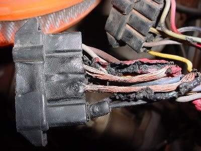

Upgrading the charging system wiring and paying attention to the ammeter is a good idea. We'd like to avoid this:
(Note: This was NOT caused by the ammeter. It's just a photo of some ugliness that can happen with wiring.)

Old pic. The Fram and the burnt wiring are long since gone. I did managed to salvage the connector body. The point is, be careful with wiring, check it now and then, and don't let people mess with it.

I thought I told you to not take picturs of my junk when I'm not around! :lol: :lol: That actually did happen to my Duster though.

That mess in the photo was the result of untrained, unauthorized people trying to put a battery in and start the car. I wasn't present, but had to pick up the pieces.
