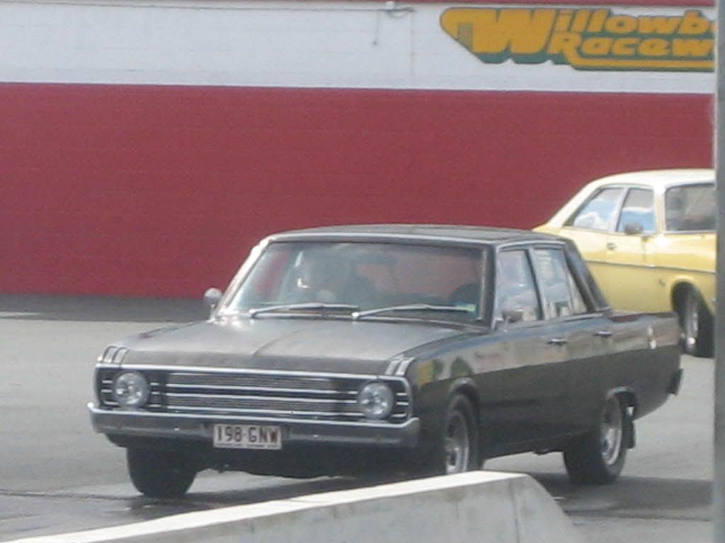

HEY WOW
I FEEL A LITTLE HI TEC NOW i`ve got a photo bucket account now so here are some pics ...
http://s256.photobucket.com/albums/hh19 ... y06009.jpg
http://i256.photobucket.com/albums/hh19 ... y06029.jpg

Very Cool! What stahl converter are you using?

HEY ALL
i am running a street style stall set at 1900-2000 rpm .. i am now looking at a good cam mine is a 25/65 with 409" lift a good daily driver cam but not good for perforamance

Is all that smoke from the tires? or the engine?

hey ted
the smoke was from the cheap tyres i got the smoked VERY well i sat in the bleach block for a bit to get them nice and hot being there a little bit of a hard compound so it made LOTS of smoke and i got some real good cheers form the crowd ..
your smoking light truck tyres
the black sheep ( non smoking please )
