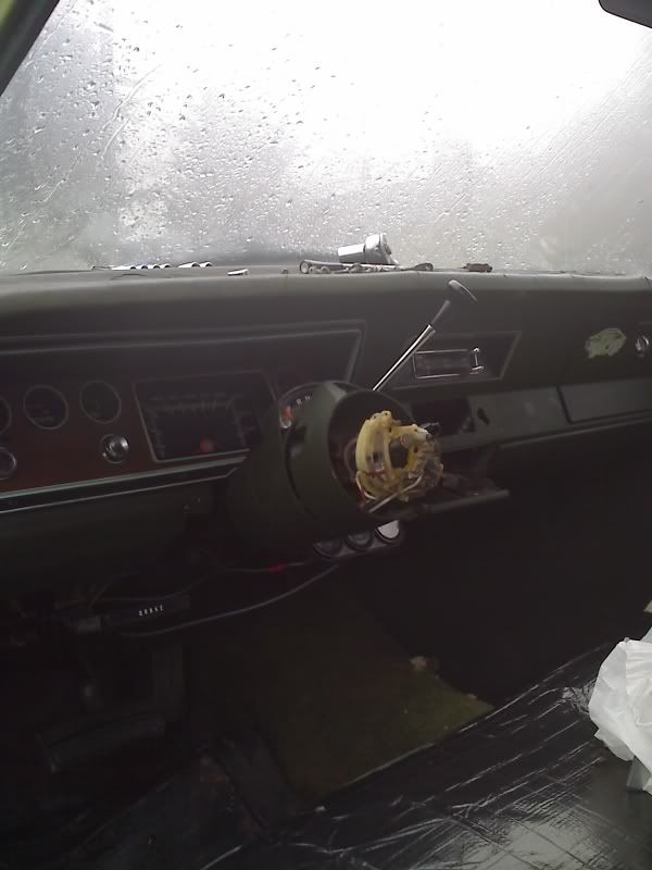

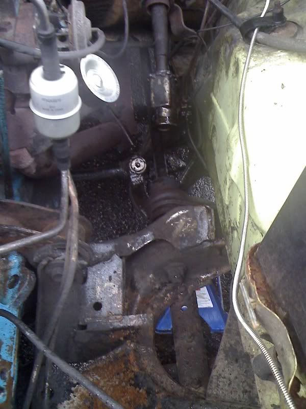

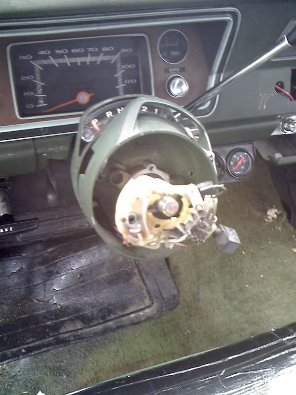

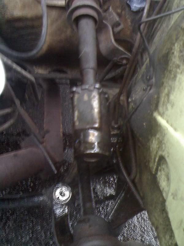

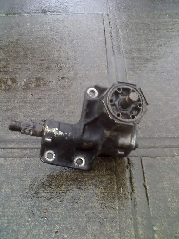

all i have to do is attach the pitman arm and limp it down to the firestone shop for alignment. got my heater core/heater valve, new deck and speakers today!
i did have to pull the wheel and it was pretty easy with the proper tools
buit i am soaked greasy and cold so i am gonna warm up for a bit before crawling under the car and getting soaked on wet pavement.
here is some picts:

yeah the roll pin is the metal thingy. hopefully tomorrow i can get the damn steering coupler to push back just another 1/4 or so more so i can get the box free.
Aint gonna happen. You have to go inside the car and loosen (not remove) the nuts holding the steering column in place so that you can slide the whole column toward the interior of the car. MARK the position of the column before you loosen it so you can put it back in the right spot.

PostPosted: Thu Jan 03, 2008 5:31 pm
Posts: 4295
Location: Gaithersburg MD

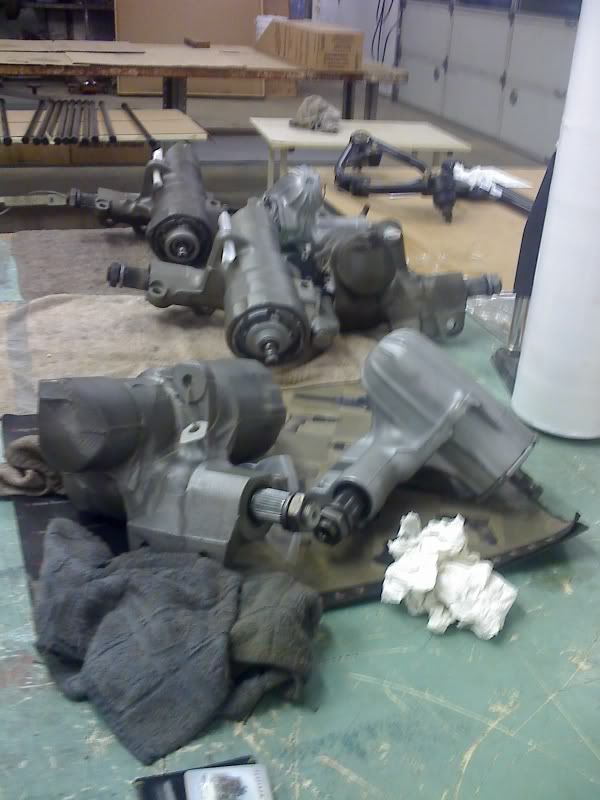

Looks like you did OK. I don;t blame you for not wanting to crawl under the car in that weather. Is it cold too? Why are there so many stearing gear boxes in the photo? And a pile of torsion bars too?
