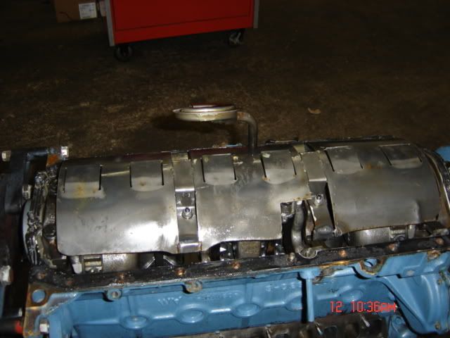

Jeffrey tray installed for a '66 pan.

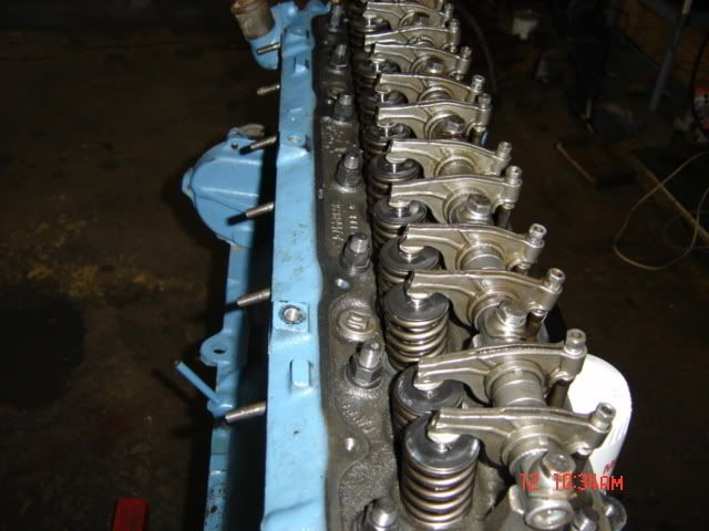

Stock rockers, nothin' fancy here.
Amazing how fast you can go with stock stuff.

Amazing how stock that all looks....
Looks like progress Dennis!

Do you spot-weld your rockers on the bottom between the rocker shaft sleeve and adjuster hole or just run 'em bone stock?
They get a minor amount of grinding for clearance on the retainer. No welding. :D
