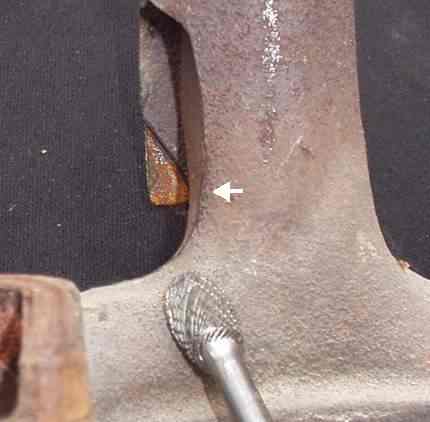

While the manifolds are off, grind yourself a little extra "working room" in that area.
Sometimes there is a large raised edge (casting parting line) that blocks access to that nut, washer & stud.
