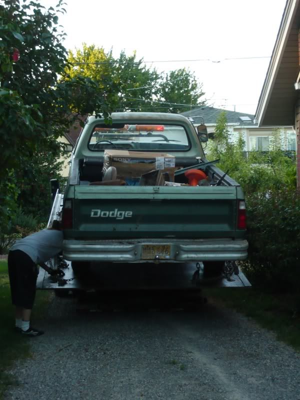

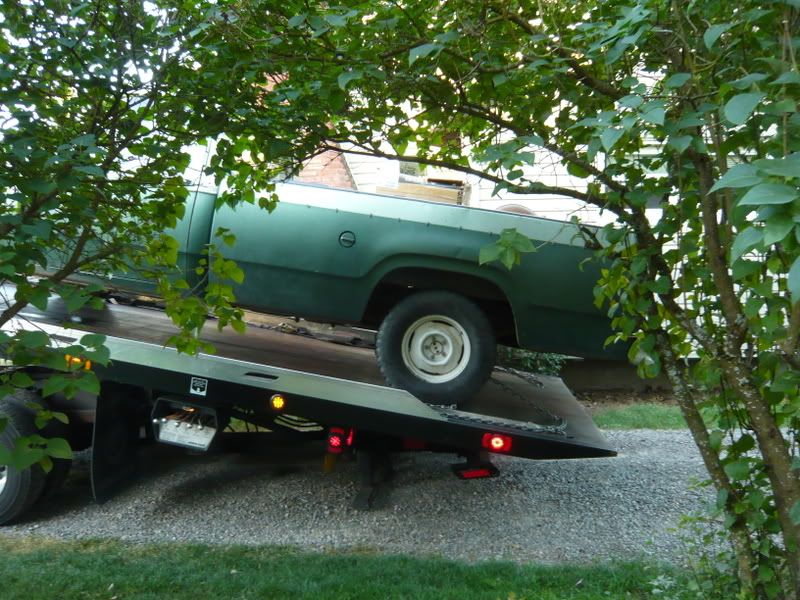

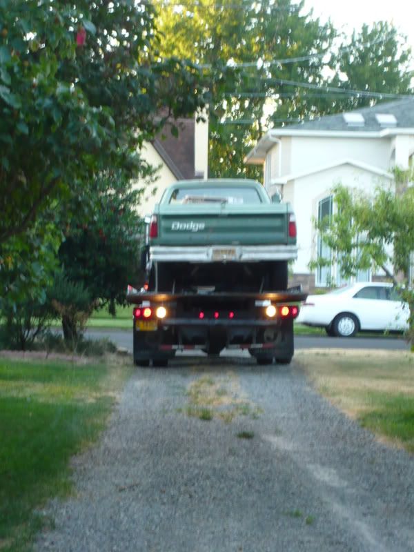

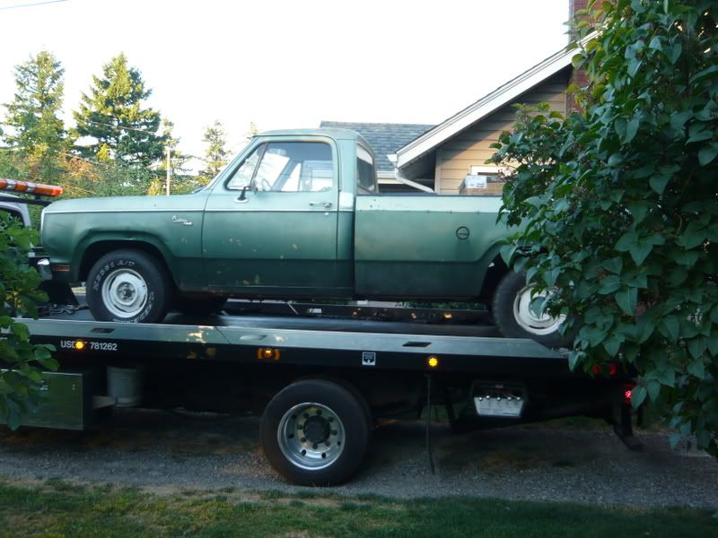

well we busted the tow ropes, right in the middle of a 5 way intersection.
i had to run into fast moving traffic and push a 4100LB truck it took every ounce of strengh i had to do it (it was up a slight grade in the road) and a ton of adreneline to get it across. with cars shooting all around us and backing up sandy blvd. after i got it across the bvld i puked.
my wife finally called a tow truck below are the pictures:
i should of never gotten out of bed this morning, the truck ran so well today also, i have no idea what went wrong. after the tow and the loss of other work i had planned today i'm hurt'n and i have a very angry wife.
anyone wanna help me fix it? i'll feed ya well and buy good beers.

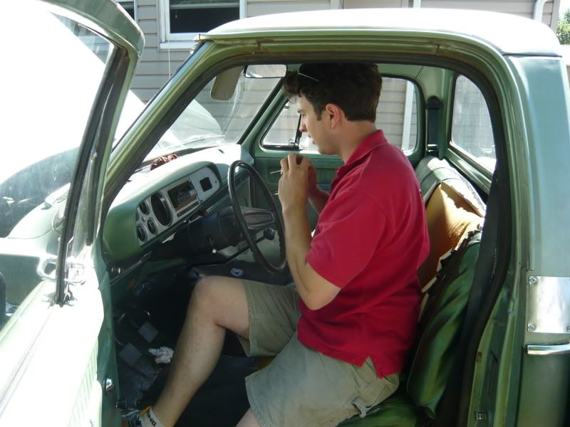

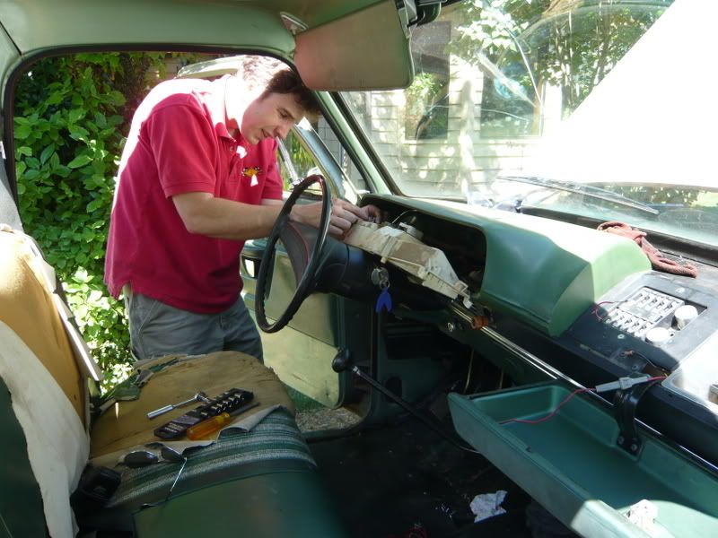

joshie fixed it right up.

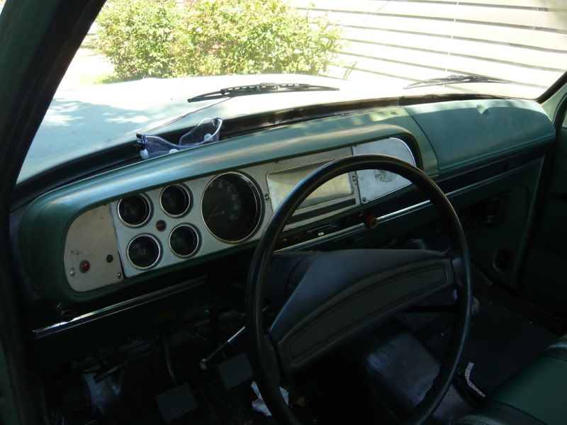

The ALT Gauge was bad, Josh figured it out in like 2 mins and had the dash apart and the truck running in 10 mins. after he left i took out the sloppy hippie wiring (radio and cb) then i walked over to the hardware store and got all new dash screws and some sheet metal to cover the radio hole.
found a taker for the radio!

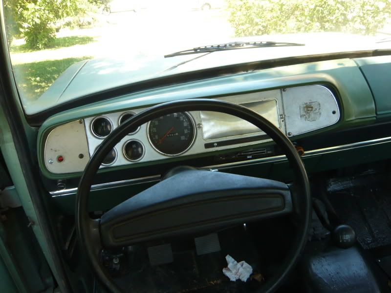

so now the dash looks like this:
much better, the truck runs! thx josh! and the wiring is now cleaned up and i don't have to look @ a crappy radio anymore.

Yeah, now we just need to hook you up with a volt meter on the left hand side above that little red light to keep tabs on the charging system.
