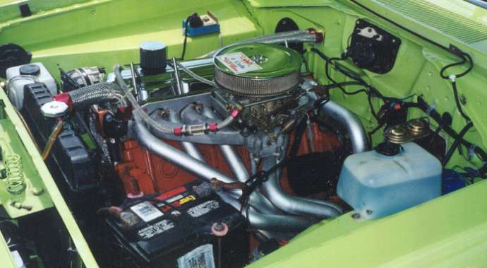

I am sold on the POR products. Just about the hole bottom of my Barracuda is coated with it POR-15. I have used it on my truck which see beach & winter duty and painted my bulked with it. Stuff is fantastic.
I am also using the POR-20 on my headers and it has held up better than any hi-temp paint I have ever used. In the engine picture below the headers have about 10K miles on them now. I have touched them up a couple of times under the car where they are exposed to road blast but looks as good as cermic coating and is a hole bunch cheaper.
The engine is also painted with POR's Hemi Orange engine paint. Not a bit of it flaking and no rust showing through.

Thanks for the post, good looking SL6 set-up.

I figured it out, that image is a real big file size. (666K) It trimmed down and compressed to 35K so now it should just pop right-up.
Nice looking engine compartment Dave.
Note the big thick extra ribs on the block, what dash number is on that block?

Doug,
I realized after I posted this it was the "big" version of the picture. I will pay attention to that in the future.
Also, if people access my WEB page via dial up it's real slow loading for the same reason (that's why I have the pictures at a lower resolution).
Another thing about Geocities is the "free" WEB page offer has a catch, they limit the total monthly bytes that can be down loaded and they monitor it on bit rate basis selectively blocking access to the site to keep the monthly total in limits. A couple or three people accessing the site at close to the same time will exceed the bit rate and shut the site down for an hour or two. The smaller images will help this too.
I do not know what the block came from. It's a late 70's cast crank, small plug motor. The original engine had been built up quite bit by the PO but he lunched it when the oil pump failed. This was a junk yard motor he dropped in. Unfortunately he did not keep the big valve ported head. I did a "back yard" re-build on the bottom end, shaved the head, added the Comp Cam, offy, 390 Holley and headers. The car is currently tucked away for the winter in a neighbors garage so I do not know when I can look for block numbers.
I hope to have a big valve ported head to put on it this spring.
