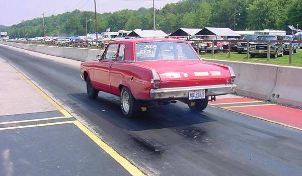

Took the piggie out to 41 for some T&T Friday night in anticipation of going to 66 Saturday for the Big Bucks race.
First hit the car was a total pig. It was so slow I'm not even gonna say what it ran. Checked this and that and tried again. Bigger pig.
Pulled the plugs and all were bone white. That in itself is not bad because pump gas doesn't really color the plugs anymore. It was unusual in that I have never pulled bone white plugs out of this motor before.
Changed power valve and tried it again. Oink.
Changed jets up a size and tried again. Fastest pass of the night but still a pig.
Pulled some timing and tried again. Picked up .8 & 6 mph, but still eating corn. It was back into an area where I felt that I had solved whatever was going on.
Took it to 66 Saturday morning and turned the bottle on. Got caught with the bottle pressure down to 800. Tried it anyway and it sounded good, but was still a pig. On a 100 shot it picked up 1.3 & 6 mph. Plugs looked great.
One time run left so I put a 140 HP tune up on it and got the bottle pressure up to 900 like it should be. Burnout sounded great, staged the car and it wouldn't hit the rev limiter on the brake. Let go of the button and it felt good, but got to 5000 or so and went flat. I shut it off and drove right to the trailer. :cry:
