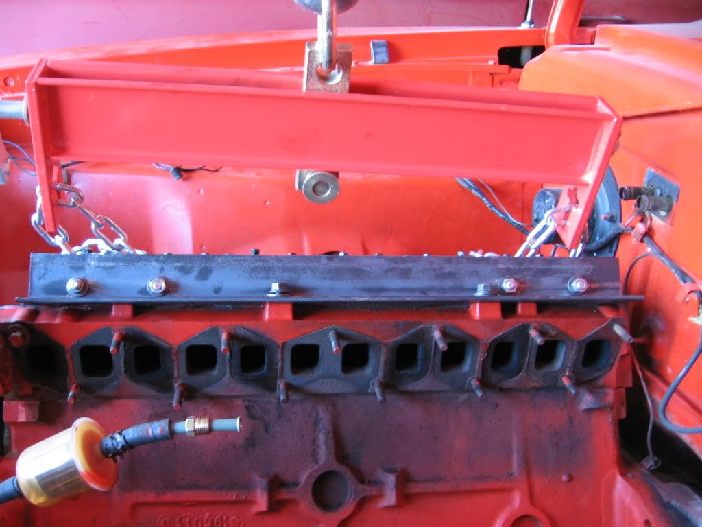

Hi all,
My slant (1967 Barracuda, 225 cu. in.) is currently out for a re-build. When I removed the manifolds, I found that the forward-most stud wasn't a stud at all, but a bolt (shown on far left in pic below):
Is this correct, or has someone changed this? When I removed it, there was water behind it. Does this mean the water jacket in the cylinder head has been pierced/punctured, or is there supposed to be water coming out of this hole? If not, any ideas on what to do or how to fix? I don't believe it was leaking, so perhaps I should just re-assemble it like this? Thanks for any advice.
Roger
PostPosted: Wed Oct 15, 2008 11:19 pm
It's supposed to be a stud and they normally do enter the water jacket so I use blue Locktite on studs I replace.
PostPosted: Thu Oct 16, 2008 8:21 am
It's definitely meant to be a stud. Put it together correctly; see here for specifics.
PostPosted: Thu Oct 16, 2008 8:53 am
Posts: 202
Location: Orange County, CA
That's what I thought - thanks very much, guys!!
