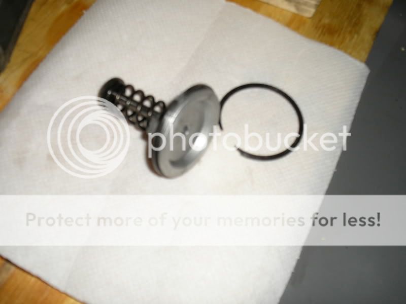

I am rebuilding my a904 tranny and have encountered a problem. The pictures in the manual show a kickdown servo assembly with two springs, a small one and a large one. The servo in my tranny only has one. The small one, and a piston seems to be missing. Did I misplace a part? Or are there different servo's for different years?
Roelof
PostPosted: Sat Dec 13, 2008 11:06 am
It sounds like your servo is fine and that the picture is for a servo from a 727. My book shows a second, relatively small spring and a washer with the note A-727 only. From outside (bottom) to the inside you should have a snap ring, piston rod guide with it's sealing ring, a snap ring, piston rod and the servo piston with 2 sealing rings.

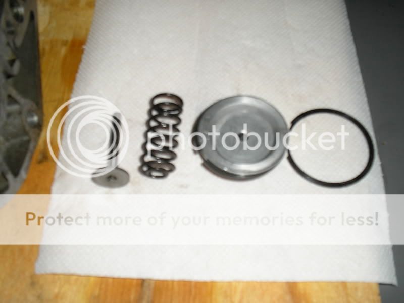

...it does sound like something is missing.
This is all there is:
So is the piston missing?
The ATSG-guide I used for the rebuild is for the 727 and 904, so I figured some parts might not be exactly the same. That's why a photographed almost everything. And a forgot to take a picture of the servo when I took it out :(
PostPosted: Sat Dec 13, 2008 1:57 pm
It does appear the piston is missing. Are you sure it came out of the case?

...ehmm.
I knew I overlooked something. Now I know what these spare rings were for :lol:
Thanks
PostPosted: Sat Dec 13, 2008 3:19 pm
So the piston was still in the case? That's good because you wouldn't have 2nd gear without it.

I spent some time looking for a piston. The case was the only place i didn't look :?
