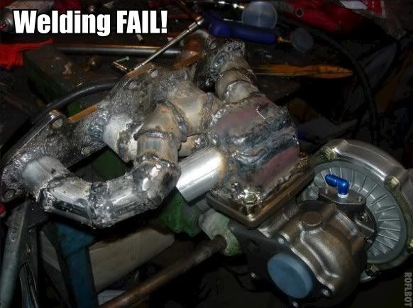

Oh c'mon now Dan. You mean to tell me that a turbo isn't a simple bolt-on? :lol: :lol: :lol: :lol: :lol: :lol:Image

:shock:
PostPosted: Tue Dec 23, 2008 3:55 pm
Angle cut straight pipe (not even curved sections) with an arc welder.............
PostPosted: Tue Dec 23, 2008 4:22 pm
Posts: 24950
Uhhhhhhhh...hey, Beavis, we're gonna, like, need some more welding rod.
