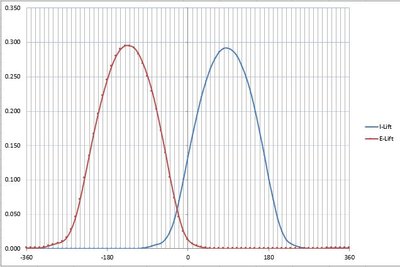

Just finished graphing out this cam. Came in a never-run rebuild with a few small issues so I'm checking everything.

https://i.postimg.cc/fRMsJLCc/DAUnknown-Slant-Cam1.jpg
PostPosted: Mon Apr 06, 2020 11:12 pm
Yup. Looks to be faithful to the original.

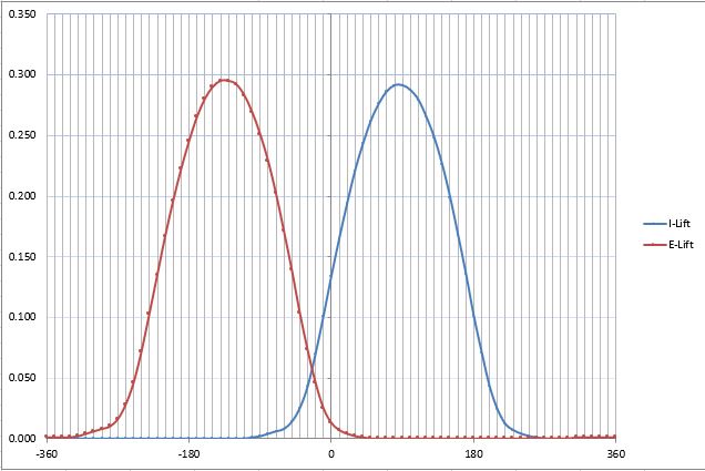

Made me smile, I thought I was the only one to plot camshafts!
I do use excel though, makes it easier to plot accurately.
You know this, but multiply by 1.5 for stock lift at the valve.
