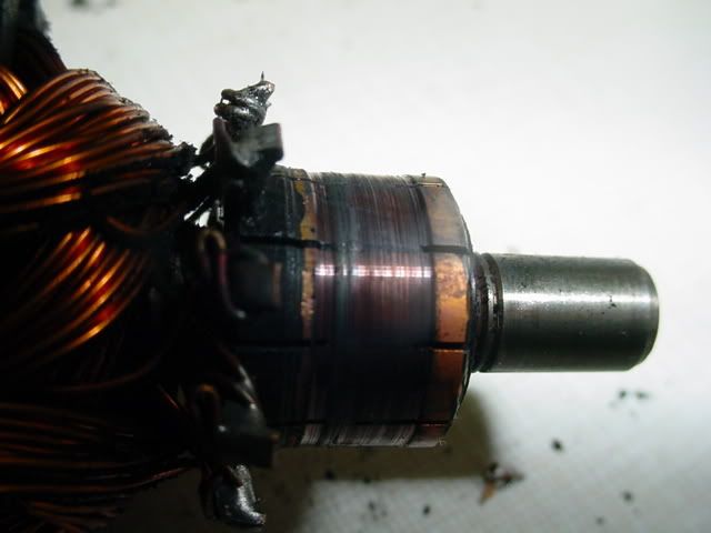

I just went a couple of rounds with my wipers ('64 Valiant, single speed). They had been operating intermittently, occasionally stopping in mid-stroke. Sometimes working the switch off and on would restart, sometimes not. When it quit the last time, it had voltage to the motor but no motion or noise.
The main fault seemed to be the well-worn motor commutator:
Cleaning the slots and lightly turning it restored operation. While messing around under the dash, I also installed the Schumacher wiper pivot seals and regreased the wiper linkages.
I haven't driven in a good rain since finishing, but it performs well under a water hose spray.
