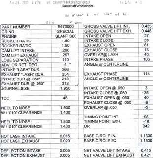

I have searched the site and tried to find the specs for this cam but there seems to be a little confusion.
Are these the specs for this cam?
http://www.dutra.org/pictures/engine/cam-260-244.jpg

I don't think so. I did find this, and I know for sure this is it. Scroll 1/2 way down the page for it. http://www.slantsix.org/forum/viewtopic ... cam#227822

I just ordered one and it is 218@.050 - .435 lift for the intake and 212@.050 - .442 lift for the exhaust.

Thank you both very much!!
