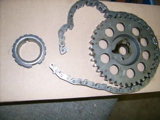

 Post subject: pictures
PostPosted: Mon Apr 27, 2009 1:16 pm
Joined: Wed Oct 15, 2008 7:56 pm
Posts: 227
Location: Stryker OH
heres the carnage
Nick
86 d150 turbo /6.
PostPosted: Mon Apr 27, 2009 6:28 pm
Posts: 1548
Location: Dallas, Oregon
Holy crap.... :shock:

 Post subject: tc
PostPosted: Mon Apr 27, 2009 8:34 pm
Joined: Sat Aug 09, 2008 5:01 pm
Posts: 516
Location: Taneytown, MD
I agree with Slantzilla,something else is wrong and caused the timing chain to fail.Either the oil pump or cam bearings are bad.
