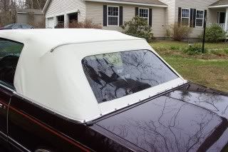

After removing the rotted moldy top & pads as well as installing new carpet padding, and cleaning & painting all that I could of the top irons, the old crate has that "New Car Smell"!

top in pic looks good. thanks again. John.
