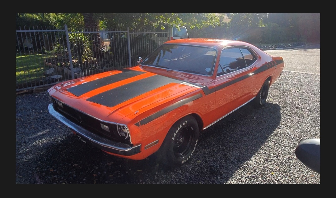

This is my car @slantsixdan is 100% correct "He has a 1971 Chrysler Valiant Charger Sports Coupé, which is a '71 Demon with right-hand drive"
My diff ratio stock is 3.23
Altitude is 400ft above sea level
But to be honest I have only learned what I know in the last year , I don't know what Camshaft timing , initial , vacuum curve are in details , I have an idea but this is the first time I've tinkered with engines .
I did all these mods myself using Youtube and Uncle Tony's garage and a mate of mine whose been a great help as he has a Slant 6 powered Valiant and a V8 Polara .
So in a nut shell , I did all the mods listed above , Set the timing , set the carb with a vacuum gauge and run low octane unleaded fuel
(All that's available here in SA)
The car isn't snappy but instead feels lazy, I mean it goes but it feels like I'm missing something .
What I would like if possible is a step by step tune up guide for my setup ?

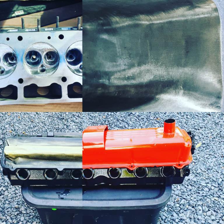

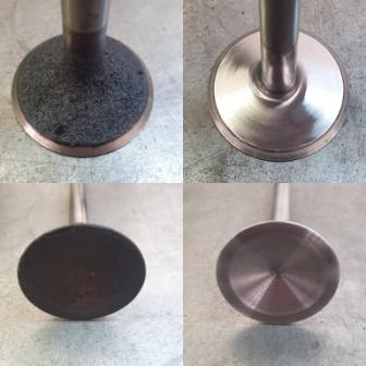

Thanks for the reply , Everything else is how it came out of the factory , I never removed or changed anything from the bottom of the engine only worked on the head . Stock cam and I haven't done a compression test .
As I mentioned before I'm a weekend hacker getting by with some youtube vids and advise from friends
1 yes I removed the steel gasket but didn't want to remove too much stock incase I needed a skim later on .
Static comp was not tested .
2 no nothing removed or changed all still stock
3 havn't checked compression and left everything in place , bores still looked good with no scoring
4 the plugs are new and last time I checked were running a little rich but I leaned that out
5 I didnt do a flow test I watched the episode on UTG where Tony just cleaned up the ports and bowls
removed all the sharp edges where flow could be compromised .
All I did was remove the little lip and clean up on the valves
See the top right photo thats as far as I went with polishing the ports then I gasket matched .

Posts: 3857
Nothing that you did mechanically was wrong, you just did not do enough to make a change in the engines performance, or address issues that may exist that are causing the engine to feel lazy.
The terminology used to describe some of the changes is not correct. A little polish on the side walls of the ports is not porting and I do not see a functional back cut on the valves. Gasket matching is the last thing that one would do to get the last bit of performance out of a precise and thoughtful built performance motor. Means about nothing on a near stock motor.
Some tips:
* If you are going to take the time to mill a head, prior to that you should cc the head, measure piston recession and use an online calculator to plan how much to cut to get to the desired compression ratio. There are lots of compression calculators on line, here is one
https://www.rbracing-rsr.com/compstaticcalc.html
* Cleaning up stock valves really does little to help port flow on an engine. As the engine runs the valves sink into the head, that recession really hurts flow at low lift. One of the real advantages to installing oversized valves is that causes the valve seats to get re cut. If you have a machinist that knows what he is doing that allows the new valve seat to be higher in the head, and that helps flow the larger diameter also helps flow. Buying the best multi angle valve seat that you can get is money well spent.
* If the motor has many miles - kilometers at all and the timing chain has not been replaced, that will retard timing and that will cause the engine to feel lazy.
* Stock slant six cams are not known as performance cams. Don't go crazy big as a bigger cam will get you more torque and horsepower, but that will raise the rpm level where that occurs and cut tq and hp in the lower RPM's. There are plenty of cam posts on this forum, I would go with something in the 210 to 220 duration, 106 LSA installed 102 ICL.
* A distributor recurve will also help, not as a fix to your current issue but as a component of the fix. Look around your area and see if there is someone with an old time Sun distributor machine. Maybe check with local car and hot rod clubs.
* Investigate the possibility that your transmission is slipping when the car pulls away from a stop, 904's and kick down linkages need maintenance to.
* the posting above mentioning doing a compression test is absolutely on track.
* Consider getting a desk top dyno package like Dyno Sim. You can use that to see the effect of changes made to the engine prior to buying and installing the part. I use one.
http://www.proracingsim.com/dynosimmainpage.htm
Poke around in the FAQ section in this forum and continue to post and ask questions.
https://www.slantsix.org/forum/viewtopi ... 19&t=38446
You have a great car to start with, keep learning.
