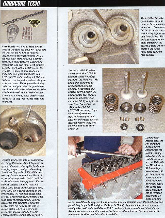

Is this engine using mechanical or hydraulic lifters?
Please check for spring retainer to valve guide interference, also check for spring coil bind. My bet is that there is interference causing the pushrods to break.
http://www.slantsix.org/articles/hrm-sl ... 03-pg3.jpg
