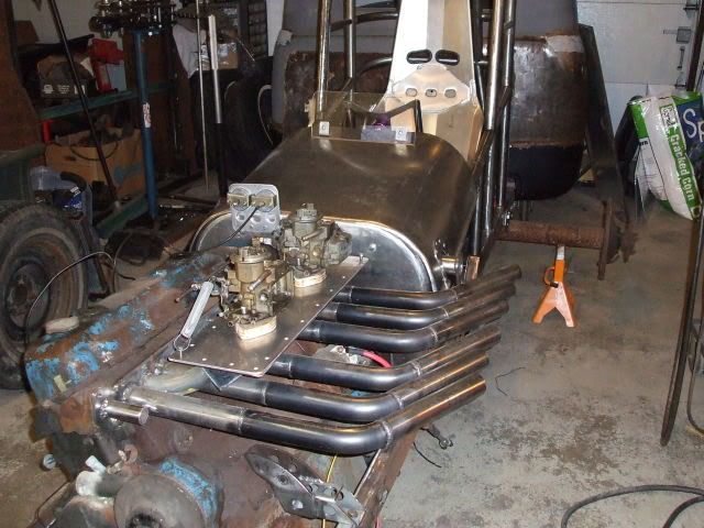

Here's a better view of the intake/exhaust. The top plate is removable so I can replace it and use any number/kind of old school carbs. Looking for recommendations for the race engine. Thanks.

PostPosted: Tue Apr 28, 2009 11:08 pm

Sweet project!! Thanks for the visuals!

a pipe for each exhaust :shock: :D :D :D :D
PostPosted: Thu Apr 30, 2009 7:11 pm
Posts: 5835
Location: Burton BC canada
Not to knock the cool look of individual stack headers......but headers with collectors would be much easier to tune and will make more power.
(If you are running nitromethane or mebbe alcohol please disregard)
