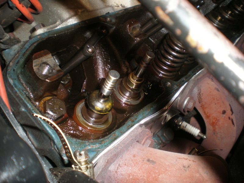

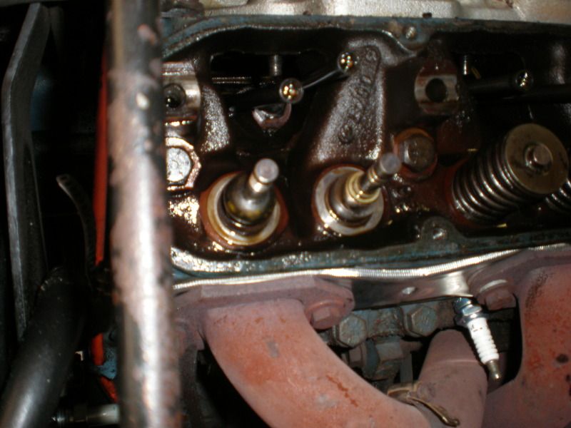

Okay, This iw what I have Found..
The Head Have been Worked on by A prior Owner and It has Crane Rocker Arms and Crane Positive Seals on the Intake and Stock Type Seals on the Exhaust..
I am going to Replace the Umbrella Seals on the exhaust as the Positive seals look good and I have no way to replace them or replacement seals to do so at this time.
