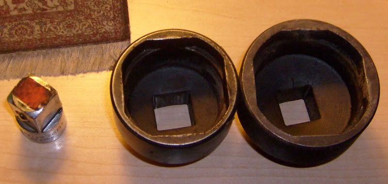

It isn't really a size per se, such as a 1/2 inch or 9/16 in socket. Mopar RWD vehicles with threaded upper ball joints use one of two special sockets for removal and installation. The socket is basically a square with rounded corners. There are two sizes, typically the smaller one is for cars and the bigger one is for trucks and vans. Here is a picture of both side-by-side:
You will also likely need that adapter that goes from 1/2 inch dreive to 3/4 inch drive. The part number on my smaller UBJ socket is: Wright brand socket, part no. 6888.
The bigger socket is a S/K brand 2 1/8 socket, part no. 84689
These are really single purpose items since they only fit Mopar ball joints. I bought my smaller ball joint socket about ten years ago and it cost me $23.50. That's a pretty step price for a tool I have used maybe twice. The bigger socket I think was around $30 about five years ago. However, nothing beats having the right tool for the job.
