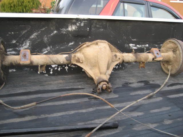

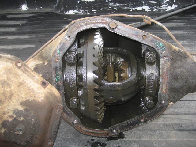

Out of a '67 F-350, complete drum to drum 35 spline with an open diff, and only 75 bucks 8)
Few pics:
Once I get my current projects for the car done I'll start in on it. Cut to the same flange-to-flange length as a stock '74 A-body axle, Mopar ends, 3.55 gearset and an Eaton Truetrac. It'll look kinda funny in a car with an only mildly built slant, but it'll definitely handle the big block when that's ready (and the coming nuclear holocaust) :D

Make sure to measure the axle tube diameter before you cut. Some of the truck Dana's have heavier tubes and the car ends won't fit. :shock:
Hmmm, I hadn't thought of the ends possibly not fitting. I suppose depengine on the thickness of the tubes I might be able to have the outer diameter machined down enough to fit the ends (I know of a good machine shop near the base that can do almost anything as long as there's metal to work with). I'll have to ask the guy to measure the tubes for me. I've already figured I'll likely need bigger U bolts and spring plates...

I thought all the rear ends used 3" u-bolts except for the 7 1/4 which used 2.5". If you have an 8.25" now, and the u-bolts are too small for the dana60, the truck tubes may indeed be different.
That's what I'll have to verify. If they're 3" or close, I should be good to go. IIRC they range from 2.7" to 4". Hopefully it'll fit....

Just had the guy who picked up the axle check the tubes for me, and they're 3" tubes!
BOOYA! I really lucked out with this one.
