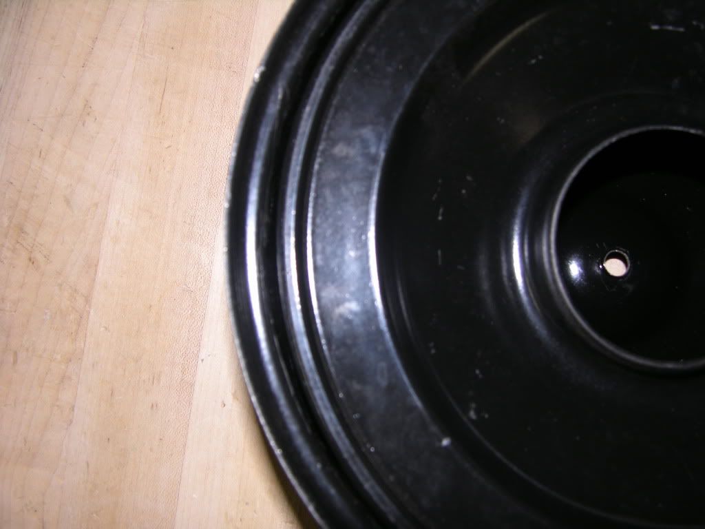

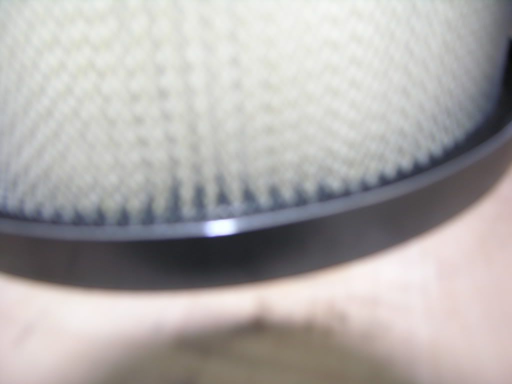

here is the really small gap

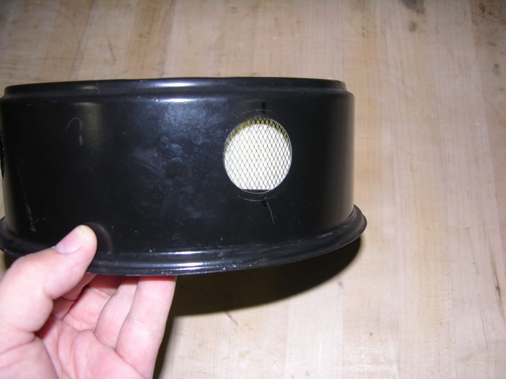

Here is the new air holes. total of eight. can not see the rest in the picture.

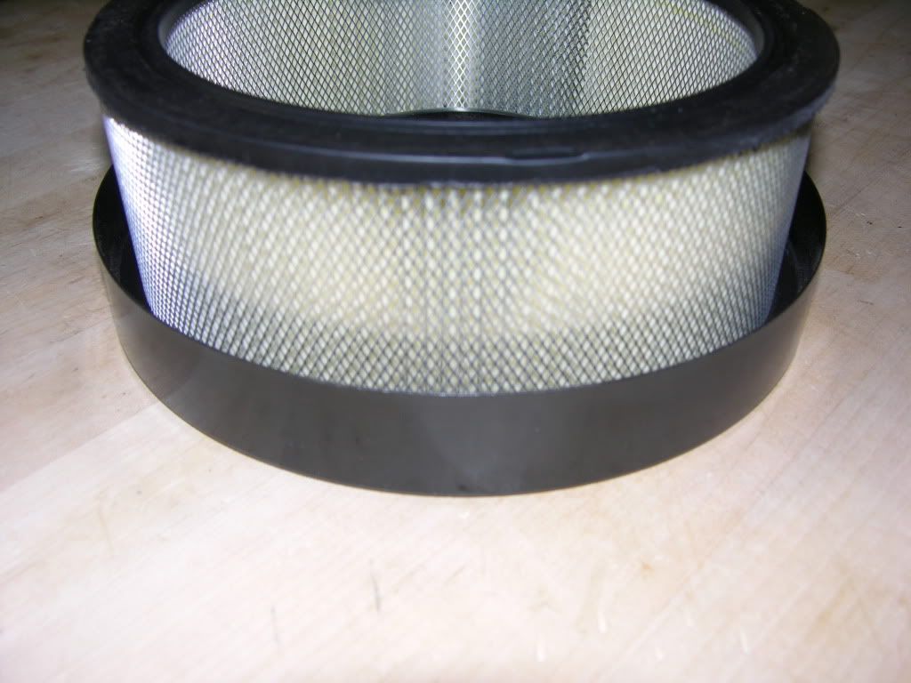

Also trimmed down the ring around the bottom plate.
before
after
i'm also going to get a k&n filter because the vacuum still climb a very little bit at 4500 to 5000 rpm but nothing like it was before.

My gap is either the same or maybe slightly larger and the carb never had any problems sucking air...........
I don't know. But without the holes the vacuum gauge starts going up at about 3000rpm at wot. With the holes it does not start to budge until 4500rpm and then only about 1 or 2 in hg. Without the filter completely removed the engine never pulls a vacuum at all at wot, which is what you want, I think. I did not have this problem before I put a 2 1/4" exhaust on the car so maybe getting rid of the restrictive exhaust increased the need or air. I hope? It also shaved 2 seconds of my 0 to 60 times and three seconds faster 0 to 75. you can hear the engine pulling harder on the second run with the holes at high rpms. also I figured the area of the 1/8" wide slit that the air had to come through it is 1.706 sqin and the two 1 3/16" barrels of the 318 carb are 2.214". besides the holes look cool. After I get payed I am goint to get teh K and N filter and see if gets rid of that last little bit of vacuum at wot.

You made me measure the air cleaner..... (did mm and inches, then averaged result)
Bottom OD 218 mm (8.5828") and 8 9/16 (8.5625")
avg 8.57265"
Top ID 223mm (8.7795") and 8.75"
avg 8.76475"
Gap area using avg:
2.6158 sq in.....
which is equivalent to a 1.825" hole......
