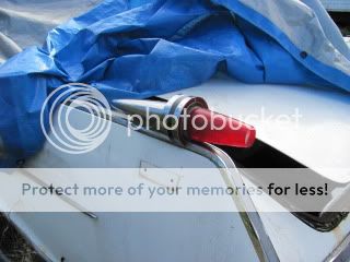

An interesting 1962 Imperial you got there 6shotvanner, one of my favorite years.
