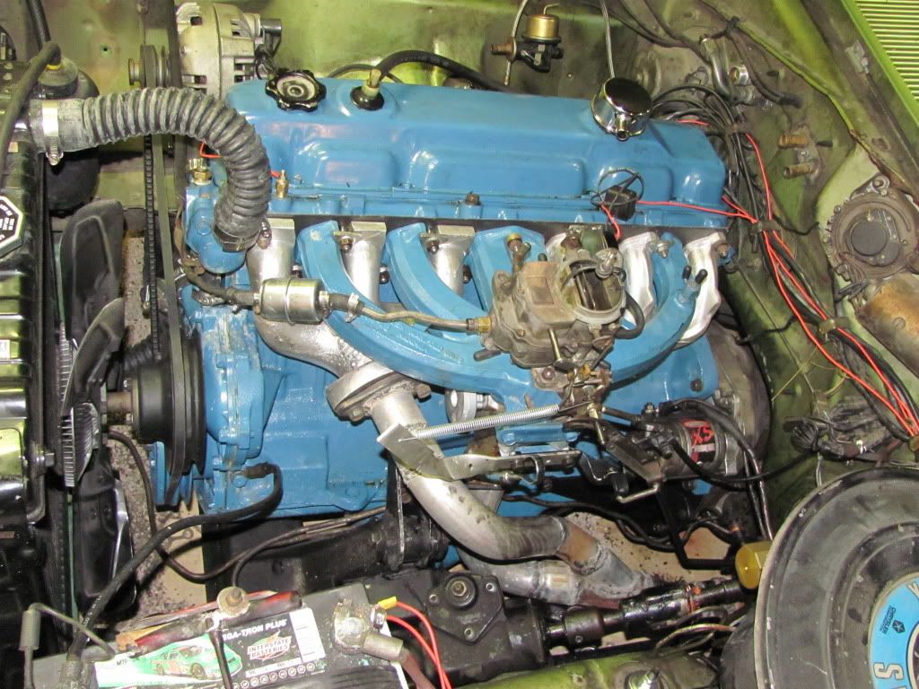

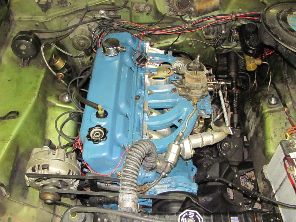

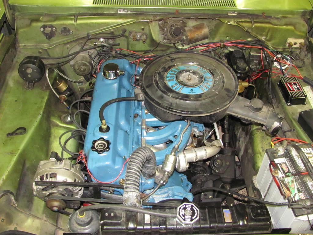

And just for laughs, I did take some pics of the engine in the car. :) (yes, I realize the PCV hose is disconected in the first two photos, took these after tonights carb re-check). Heater is disconected till I get the engine running right, and this is an A/C car. Planning to get a Sanden bracket from Charlie and going that route.
