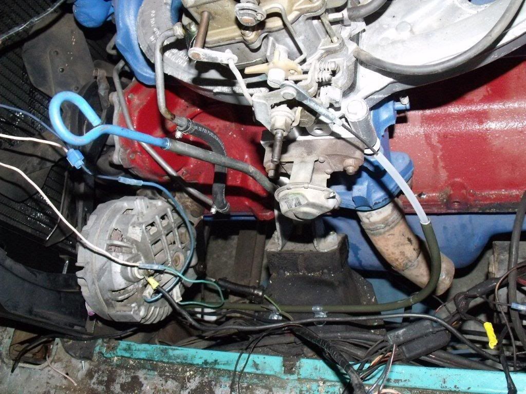

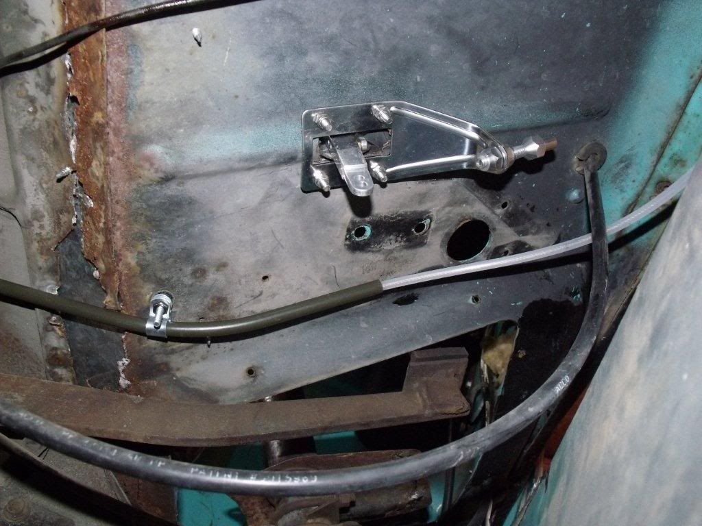

I used a VW style cable on mine 225 Super 6 in my A100 van. Works real well too...I used a big piece of hard brake line and bent the end up twards the carb and ran the VW style cable thru that to help keep the cable from getting too hot.
<a href="http://s269.photobucket.com/albums/jj52 ... esetup.jpg" target="_blank"><img src="http://i269.photobucket.com/albums/jj52 ... esetup.jpg" border="0" alt="Photobucket"></a>

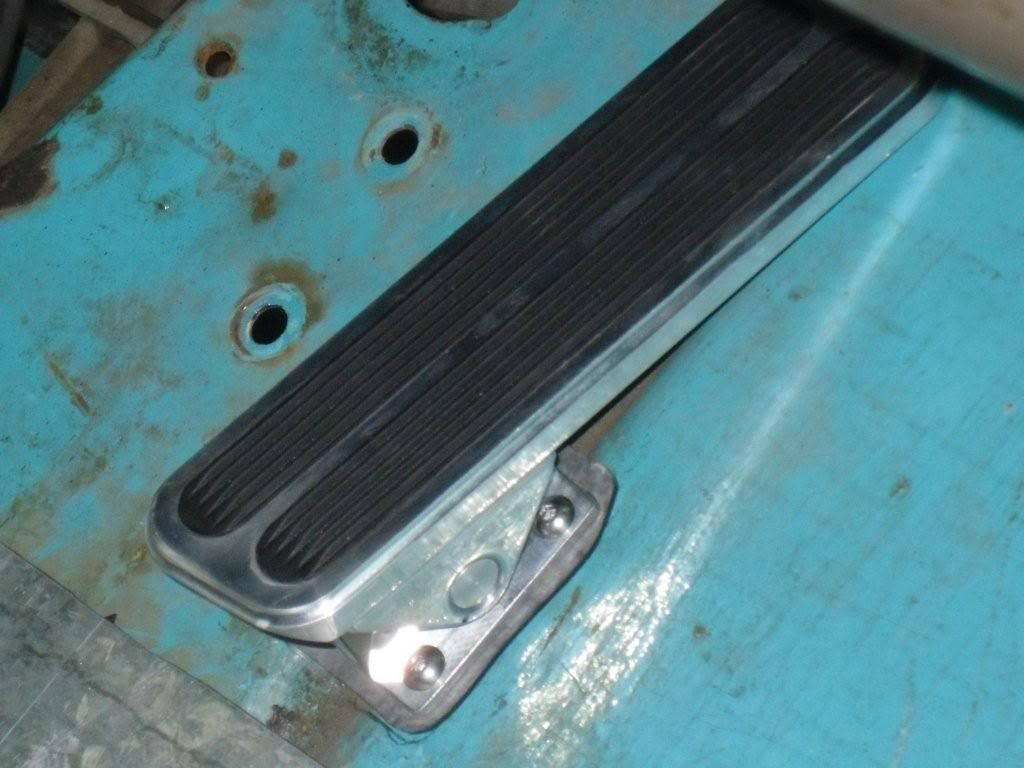

I also replaced the stock pedal with a new style.
<a href="http://s269.photobucket.com/albums/jj52 ... seup-1.jpg" target="_blank"><img src="http://i269.photobucket.com/albums/jj52 ... seup-1.jpg" border="0" alt="Photobucket"></a>
<a href="http://s269.photobucket.com/albums/jj52 ... inkage.jpg" target="_blank"><img src="http://i269.photobucket.com/albums/jj52 ... inkage.jpg" border="0" alt="Photobucket"></a>
Hope this helps ya out.. email me at kent@kltcustoms.com if you need anymore help!
