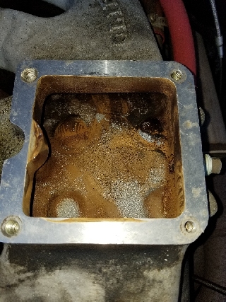

I've got two problems with my /6.
I have a massive vacuum leak and signs of coolant in the intake plenum and runners.
I think it's a leak in the water heating jacket under the plenum, the guy that now owns Clifford Performance says he doesn't think it's the intake.
I've never seen signs of this much rusty water in an intake because usually, the intake flows lots of air in the other direction.
There does not appear to be water in the oil or oil in the water and when you dribble gas down the carb it runs fine.
It will only start briefly with what the accelerator pump squirts into the manifold and will not idle.
I would suspect a blown head gasket but the engine still runs really good. No swapping holes, no missing.
Has anyone here ever seen coolant in an ordinary non-water heated /6 intake manifold like this?

If the plenum above the water chamber has eroded, which it could over time and antifreeze that isn't aluminum compatible, then coolant from that chamber could be drawn into the intake. The air/fuel mixture is pulled into the cylinders, so it's under vacuum, not pressure, and acts like a big straw and if your plenum is cracked to the point of coolant seepage that could be your problem. I would disconnect the water source from the intake and see if it stops. If it continues with no water going to it then your problem is probably deeper inside.
It is. Either that, or somebody in Transporter Room Three played a prank on you and beamed some coolant into your intake plenum.
the guy that now owns Clifford Performance says no way.
The guy that now owns Clifford Performance is a notorious lie-bag.
No, it doesn't happen. There's no path for it.

The below is the email thread between myself and the guy that owns Clifford Performance now.
I came up with a way to isolate and find this leak(s) and he told.me flat out if I plug off the water jacket I will have to buy a new intake. When I asked him why, he didn't answer me.
The radiator and most of the cooling system is empty right now. I told him that and that I was just going to clamp the inlet and outlet hoses temporarily and try to start the car with a newly rebuilt carburetor.
This way I could see if the water jacket is the source of the vacuum leak. He said doing that will ruin the intake.
I've tried to imagine why doing this would ruin the intake and I can't. Anyone else here have a clue?
"Do not plug the water jacket or you will be ordering a new intake"

How about disconnecting the water hoses from the intake. Capping one of the connections, and hooking up a vacuum pump to the other connection. Pull a vacuum, and see if it holds.

That would be a good idea except I don't have a way of pulling a vacuum. I have a Stant radiator tester with a leak down gauge which would do the same thing but neither method shows where the leak is actually located.
I could probably pressurize the water jacket and spray Windex or soapy water into the plenum and look for bubbles but that leaves no permanent witness mark to weld over later.
If clamping the water intake and outlet hoses stops the vacuum leak, then I open the water jacket on both sides and use an air hose to blow all the coolant water out and dry it.
Then I apply Dykem blue layout dye mixed with acetone to the floor of the intake plenum.
Then I take my endoscope and cellphone camera and stick it into the water jacket and look for cracks or holes with blue dye seeping through.
The guy that now sells these Clifford systems says plugging up the water jacket and starting the engine briefly will ruin the intake and I don't get why.
Maybe I'm missing something.
If clamping the water intake and outlet hoses stops the vacuum leak, then I open the water jacket on both sides and use an air hose to blow all the coolant out and dry it.
Then I take my endoscope and stick it into the water jacket and look for cracks or holes with blue dye seeping through.
The guy that now sells these systems says doing that will ruin the intake and I don't get why.
Larry says a lot of things that don't make sense, or are total lies. When he is corrected, he doesn't listen and fix the problem. It is a shame Jack didn't make provision for the company to continue as it was when he was alive.
PostPosted: Wed Feb 15, 2023 8:16 am
Posts: 17640
I cannot see how that will ruin anything to plug the water jacket. I would blow it out with compressed air (or your mouth), let it dry a little, then put plugs in. I have run those intakes with plugs in the jackets for years and 10s of thousands of miles.
PostPosted: Wed Feb 15, 2023 8:47 am
Posts: 1345
Location: N. Ga.
Car Model: 64 Valiant
Like Lou said, he and many people have driven these intakes and other water heated ones with plugs in them and even with no plugs at all without issues. Sounds like he's trying to scare you into buying and intake by convincing you that you did something wrong if you disregard his advice....
PostPosted: Wed Feb 15, 2023 9:19 am
+1 My Clifford is plugged.
PostPosted: Wed Feb 15, 2023 1:34 pm
Posts: 9499
You may have a crack letting water in, but that is not going to be the issue with it not starting or having a massive air leak. If it would be big enough to let that much air in then it would be sucking water into the engine just as fast.
PostPosted: Wed Feb 15, 2023 4:41 pm
Posts: 25072
I sort of wonder if he actually believes this crapola he's shovelling, or if it's just a slightly modified version of a caught little kid's dog-ate-my-homework desperation.
This way I could see if the water jacket is the source of the vacuum leak. He said doing that will ruin the intake.I've tried to imagine why doing this would ruin the intake and I can't.
Because it won't.
You're being lied to.
Even if this were true, which it isn't, I would like to hope you sure as all hell wouldn't be ordering a new intake from him!
> Do you have a PCV valve going to the carb or intake? This will cause a vacuum leak.
Horsepuckey. No, it won't. The whole reason why we have PCV valves rather than just an open line from the crankcase to the intake tract is so there won't be a big ol' vacuum leak.
> Take it off if it is still around.
Wrong. PCV = only good, not bad. Remove PCV = only bad, not good.
If I can locate the crack and depending on where it is, I may be able to fix it without taking the manifold off the engine.
Donno what you have in mind, but the methods that come to my mind all amount to a major gamble on your engine's continued health.
> It could be the water jacket started leaking into the intake.
He's contradicting himself.
If you plug it now, gas will go into the water jacket and cause some serious problems.
Um…nnnno.
Star Bright tank cleaner
Speaking of lies. "Enzyme-based fuel tank cleaner"? No, I rather think not.
I had had a glass fuel filter with a plastic cage and plastic screen in it that disintegrated into dust and got pumped straight into the newly rebuilt carburetor.
Glass fuel filters were a bad idea when they were available. They're even a worse idea now all you can get is Chinese trinkets shaped like fuel filters. Use a real, metal fuel filter.
When the car quit down the street the first time, we had put Zerex radiator flush in it and were trying to run it around the block to get the flush distributed through the system.
Radiator flush is a light-duty cleaner for use on lightly-dirty radiators. Nowhere near adequate for the amount of crud and mud in the average old car. But that's beside the point: driving the car doesn't make any kind of radiator flush or cleaner work better than running the engine in the driveway.
Did you add zinc to your oil at any time?
And in this slide, we see ol' Pants-On-Fire Larry tossing out random nonsense to point your attention away from the actual problem.
I was waiting to find out more about the problem with the Challenger engine before biting the bullet and ordering that adapter plate gasket from you
If absolutely nothing else, learn the lesson of this experience: do not give Clifford any more of your money. This what you're experiencing is not a one-off. This is what they do: bad advice, blameshifting, and shoddy products. That's not how it was 35 years ago, but…this is 2023.
