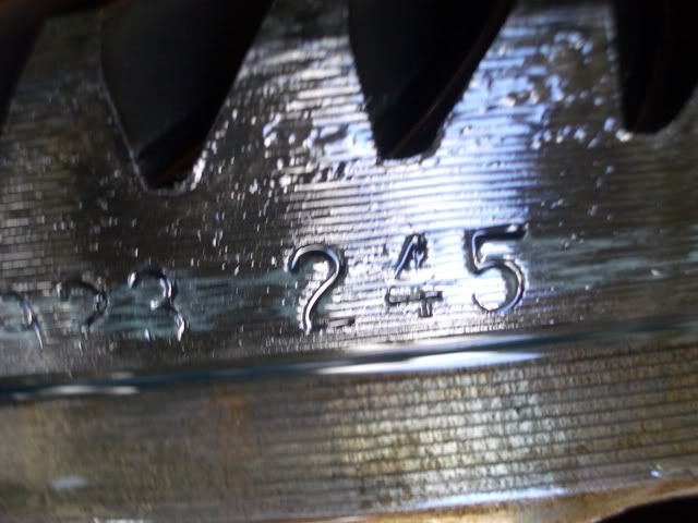

mis Amigos, I have a Rear End Gera size question..
I opened the rear end to see the numbers that are stamped in the Ring gear, and this is what I have, hope some one can tellme what type of ratio I have: 2852923 245 7 21 75 2
I need to know what I have, it is a 8 1/4 rear end that I purchased few months ago.

PostPosted: Thu Mar 17, 2011 2:15 pm
Posts: 4880
Is the "245" really 2.45?
PostPosted: Thu Mar 17, 2011 2:33 pm
Joined: Mon May 03, 2010 7:41 pm
Posts: 46
Location: Redwood City California
yes, that's the number I got , is it rare?

PostPosted: Thu Mar 17, 2011 2:43 pm
Posts: 4880
2.45 is the gear ratio, those are pretty common.
PostPosted: Thu Mar 17, 2011 2:55 pm
Posts: 46
yes! it is a 245 number. hope you can see the picture.

PostPosted: Thu Mar 17, 2011 3:05 pm
Posts: 4880
What is the gear tooth counts?
Divide the number of ring gear teeth by the number of pinion teeth.
54 / 22 = 2.45
PostPosted: Thu Mar 17, 2011 3:06 pm
2.45 gears were common with V8s. They are not very fun with a slant. I hope your car is an automatic.
