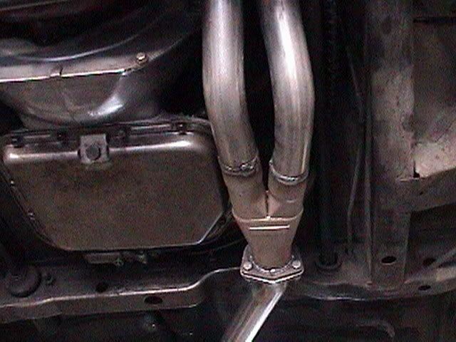

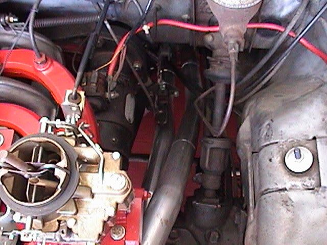

There's a slip connection about parallel to the steering shaft where the headpipe tapers down and in. Shouldn't have a leak problem per the plumber. If it ever becomes a problem, a step down band clamp can be put in

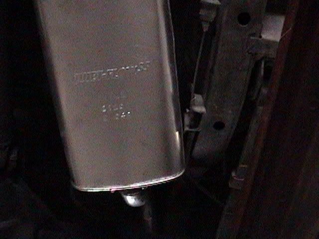

The Walker 21200 was a tight fit

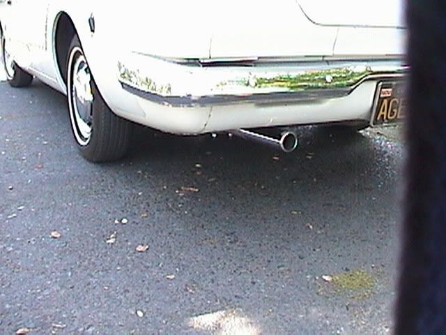

Gotta have a chromey!
