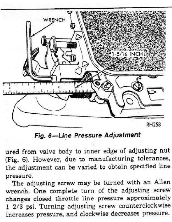

I would go a full turn on this transmission but to be honest, it is best to install a pressure gauge into the test port and take a pressure reading, prior to going into the trans... then adjust, based on that.
The FSM describes the test & adjustment in detail.
You will have to "cut-down" the allen wrench if you want to do the adjustment while the valve body is installed.

Thanks for the nice detailed photograph.

I got this photo from what it looks like to be the same source as the photo from Doc.
It says to turn the screw counterclockwise to increase pressure.
Am i missing something ?
I will be having a go at adjusting the bands and line pressure soon on my 904 Torqueflite (push button auto,1963 Valiant).
As this will be the first time i have done this procedure myself,i would like to get it right.
