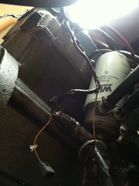

Wix 51773. Here is one installed on the slant in my brother's van. It might be overkill though.
The 51515 wix filter has the same flow ratings as the 51773 and has a 21 micron rating and the 51773 has a 32 micron rating. my $.02 worth

Yeah, but the 51773 is just so BIG! :lol: Seriously, the Napa Gold 1515 or Wix 51515 is the better filter, not only because it will fit better but it filters finer particles.
