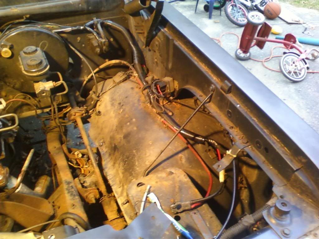

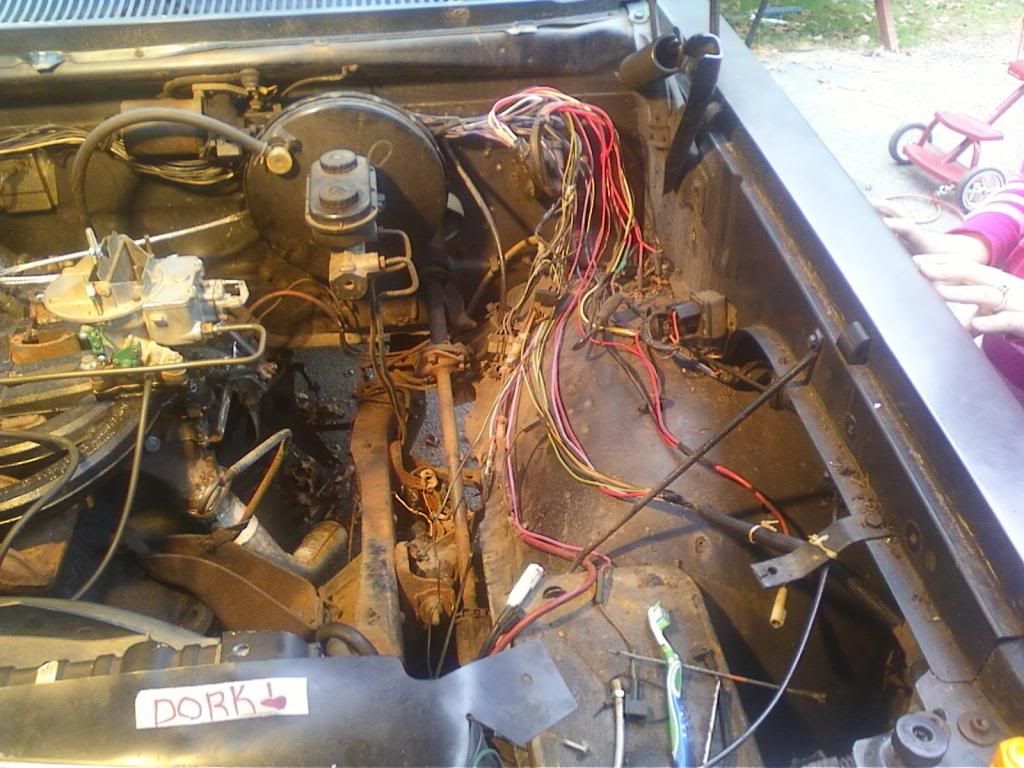

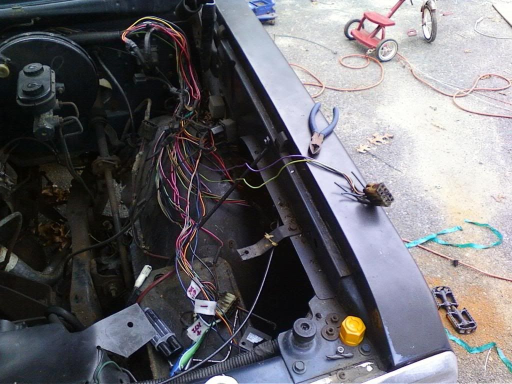

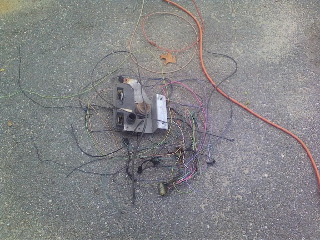

didn't get to drop the dist. in today, I did get the fuel tank and throttle cable taken care of, and got all of the leanburn wiring pulled out.
what a mess of crap, there was even more when I was finished.
Everything taped back up.
I took the time to remove all of the wiring because I can't stand a half a$$ed job.
