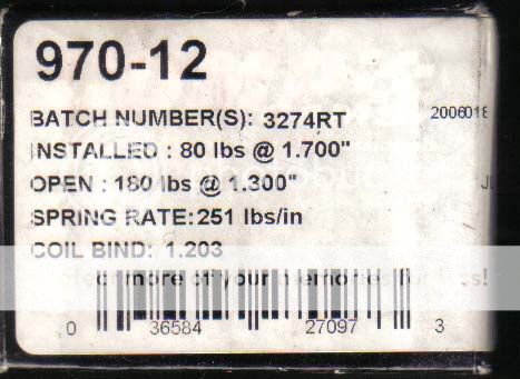

hello. i am picking up the block, crank and piston assemblies from the shop this weekend and am delivering the head. i am going to use Oregon cam grind 1475 (282 dur/.495 lift) and need to know if these Comp Cam springs will be good match.
thanks in advance, andy.
edit; will be installing engbldr oversize valves.

If you're really pushing .495" lift those springs are going to come close to coil bind. Those springs are a bit on the soft side and won't tolerate increasing the installed height to prevent coil bind either. I would buy springs with dampers and retainers from Engnbldr.
