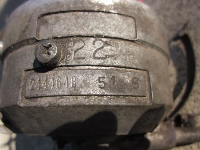

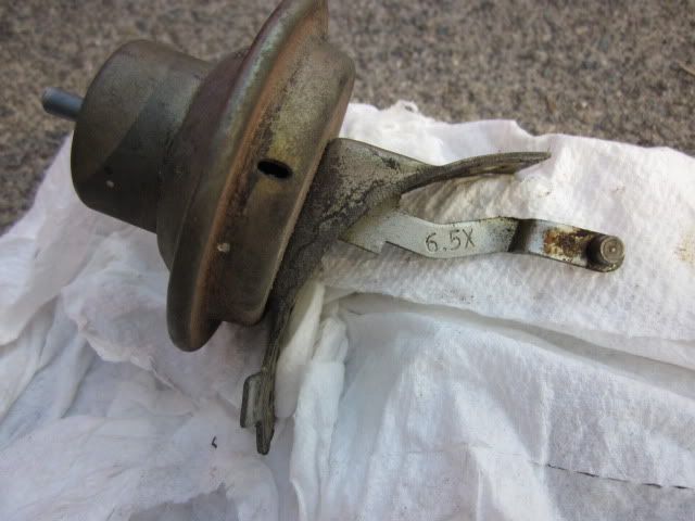

I just found out my vacuum advance diaphragm is leaking, so I need to replace it. When I took the old one off, I found it had "6.5X" stamped on the arm. Just curious if anyone knows what this indicates? Is this related to the number of additional degrees advance? I couldn't find any other numbers on it, but the distributor had the number 2444648 stamped on it. Thanks for any info.

There is a thread in the FAQ that goes into the different vacuum advance cans, and what the numbers mean.
http://www.slantsix.org/forum/viewtopic.php?t=13198
On the page is discussion about the 6.5X being 6.5° of Distributor advance.
Dan listed a bunch of the part #'s in the first post, so take a look at it.

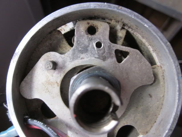

The EI distributors have their pick up plate that has 2 holes one for each style of vacc. advance arm. I have found depending on the year of the points distributor they may or may not have the hold that is needed for the EI Vacc. advance arm. I know that the 1965- distributors i had did not, but the stocker late 60's-1972 distributors I have do... You can swap the plates around if needed, but you will need to look at your points plate to see if it will accept the later short arm with the bend going the other way.
-D.Idiot
Good catch, Duster. I just checked my plate, and it does have only the one hole. Looking at pictures of the VC-208, I can see that the arm curves inward, instead of outward like my current vacuum advance does. Unfortunately, I don't have any extra parts to play mix & match. Anybody know of an adjustable vacuum advance that will fit my distributor?
Alternatively, I suppose it's possible to drill a second hole in this one, but that would be a one-shot deal! Can someone please post a picture of the later plate, so I can get an idea of the spacing?
