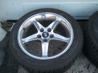

Lou and Sandy this is for you or anyone else who has experiance with mustang wheels on abodys.
I am finally getting a chance to get the car back together. I just scored a sweet deal on some mustang cobra take offs. And the 8.8 is going to the machine shop next week for its surgery. Shortening it for 2 short shafts, and then they are going to be welding on the perches and shock mounts. My question is should I have the leaf perches move inboard to give alittle extra room for the tire and wheel? Tires are 245-45- 17s. And if so how much. This is going on a 64 valiant 2dr by the way.
PostPosted: Tue Mar 20, 2012 5:54 am
Posts: 17475
Those tires *just* fit with a little rubbing in some extreme instances. Worse rubbing with rubber spring bushings and I run poly. Gotta get the spacing just right.
At this point, I would definitely get them to weld the perches 1/2" inboard and order a 1/2" spring reloc kit from doctordiff.com. I am planning to do this on my '64 Dart. Good thinking!!
You might have more trouble with the front on your 64 V due to the smaller wheel arches than the Dart. Let us know how you make out there. I did some trimming on the rear edge of the front lip of the wheel opening (hits on turning).

So far with out bolting anything up it looks like the fronts will need some clearancing to happen. I may get away with pulling the fwd lip out some. If not I might cut the fender and move the front lip forward and patch in the difference.

Sounds like a good plan. I will probably stick with narrower tires (225s or 235s) on my new '64 Valiant. 225/50-16s on there now.

I was able to use 245s on the rear ,,,,,,,and 235s on the front,
I had to rework the fender " corners" to clear on the front.
