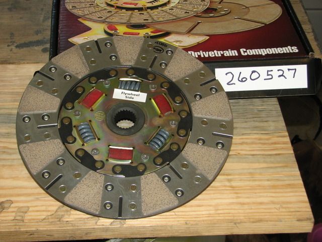

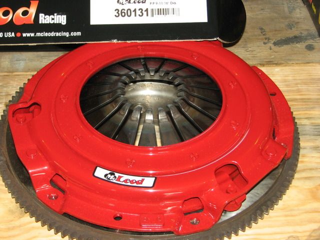

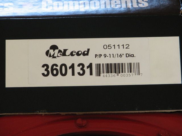

 Post subject: Clutch and PP
PostPosted: Sun Jun 03, 2012 1:28 pm
Posts: 9532
Here are the photos of Ryan's clutch that we just got from Mcleod a couple weeks ago.
