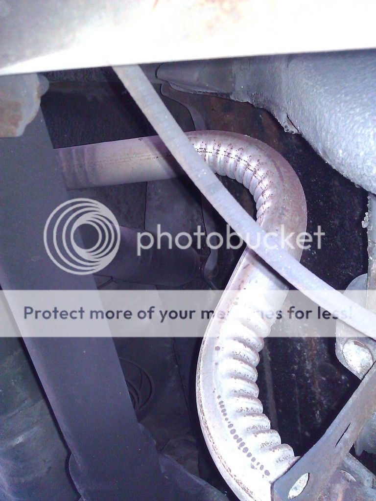

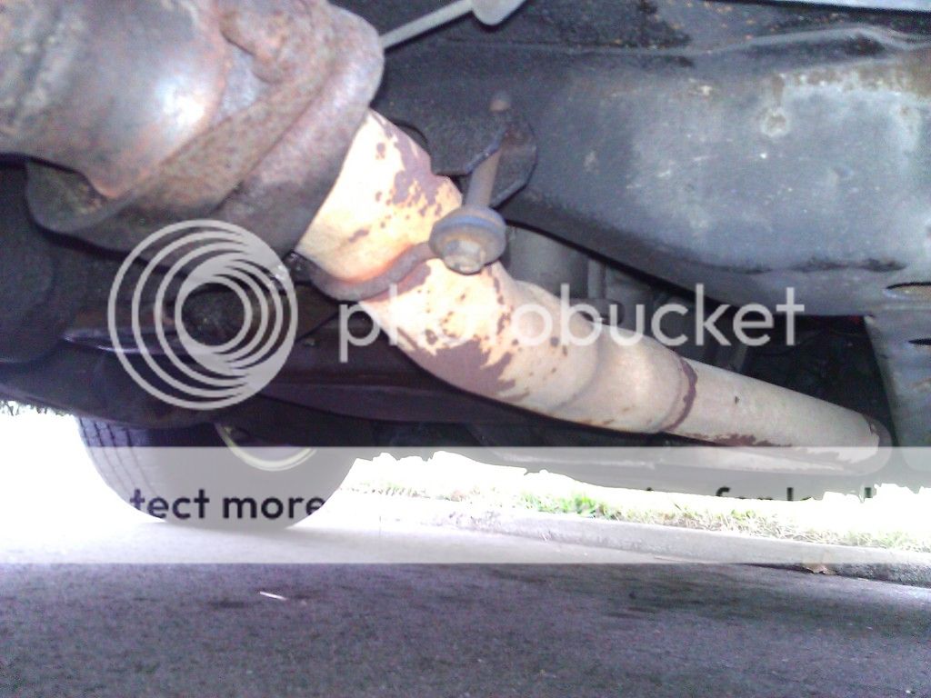

I'm getting ready to get my dutra duals installed and have dual exhaust (2" pipe, X piped behind the tranny into 2 26" glasspacks). I wanted to get some opinions on the routing I have come up with and some thoughts on if it's worth putting mandrels on. Mind you, i've never done exhaust before (as this is my first car and therefore have very little prior automotive experience). Well here is a crudely drawn picture of my current exhaust route.
(Red line is exhaust pipe, M=Muffler, C=Catalytic, E=Engine, T=Tranny; the pipe goes over the rear axle)
And some bad phone camera pictures of my current exhaust here, here, here, and here

have you considered a 2 into 1 collector
like the flowmaster shown here? Sumitt probably has the best price..
http://www.flowmastermufflers.com/searc ... &sc3=&sc4=
gets you some exhaust scavaging,, saves a little pipe weight and installation hassel.
I set my Dutra duels up with one of the flowmaster collectors,, I made the down pipes leading to the 2 into 1 adapter about 30 inches long,, to simulate a long tube header,, don't know it it makes a difference, but I think it looks neat.

Why route them down the passenger side? Save pipe and the price of the elbows and run them down the driver's side like the A-bodies... (also each elbow acts as a slight restriction in flow...and provides a prime place for condensation to settle when the engine is shut off overnight).
(Or you can split the difference and run the front 3 down the drivers side, and route the other as you have drawn down the passenger side...which is how I have my duster set up...but if I were to do it again I might think about doing Dad Truck's collector single pipe right out of the gate, then run one left and the other right...)

i put duals on my 318 5th avenue and moved the tank over one strap and its been fine. Seen many other cars done that way
