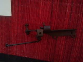

I believe it may be part of the Super Six Linkage but not Sure.
As I am cleaning out the shop and scrapping junk that no longer needs to take up my space I found this linkage in a box of slant six stuff I got from a guy I bought an old engine from years ago.

That is a partial one barrel kickdown linkage. Can't give more detail than that.

Slant-6 kickdown linkage bracket, bellcrank, and upper pushrod: '62-'67 B- and C-body, '65-'66 A-body with factory A/C, '67 A-body.
