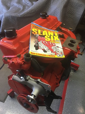

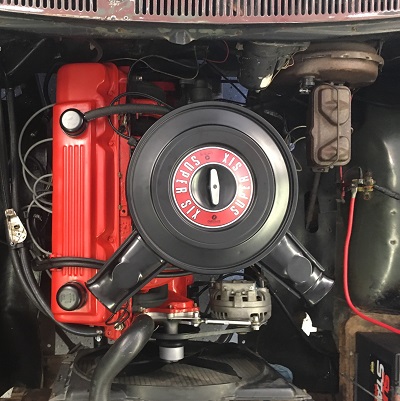

This past week things really came together. I had taken off work to focus on getting this deal done. One surprise came the Friday before when I visited my machinist and learned that he had had carpal tunnel surgery and was recovering nicely. During that and the recovery, work piled up and things got placed on the back burner. This meant the drool tube head wasn't going to be done having big valves installed. "Plan B" was to swap the peanut head from the old engine. So that's what I did. Other pieces came over as well, all the brackets, water pump pulley, oil pan and pickup, manifolds, distributor, etc.
My son was able to join me Thursday evening. By that time, the engine was ready to go back in, and just before noon on Friday we started The Sandman for the very first time.
