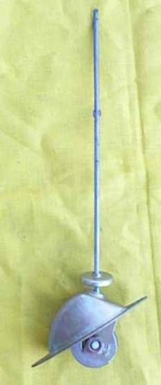

So inherit this 1968 valiant with a slant six from my step daughter after she set it on fire. I had the engine overhauled, replaced the carb (holley 1920(after trying a seriously dis functional carter) exhuast manifold pertronix ign system and a bunch of nuts and bolts. I got down to the choke thermostat and I broke it, I have temp fixed it by disassembling the thermo stat and replaceing the rod I broke w a coat hanger, now I am have a issue with it hanging so I've decided to replace it oem or go electric choke.
1. Does anyone know where to get the right choke thermostat and or part number?
2. Pro or cons of the electric choke?
3. Oem calls for 0 to 5 degree before tdc I am currently running about 12. Is this normal for changing the ign system?

!. Chokes are getting rally scarce. If this is like yours
You CAN get one from http://www.thecarburetorshop.com/ When I was researching my Carter carb one of the carb folks I spoke with called the owner "Crazy John in Missouri"
He only sells the choke with a rebuild kit and they are not cheap. There may be other sources, maybe ebay sellers stores??? If you rebuild it, you'll know it intimately. If ya just want to drive it, keep looking.
