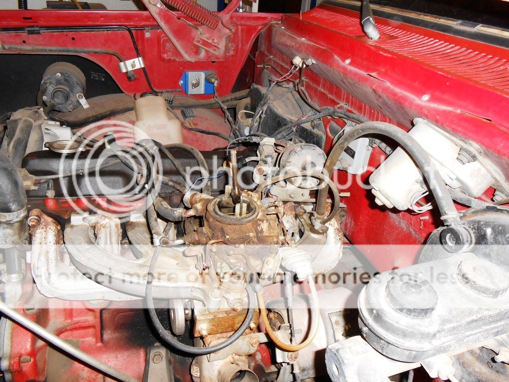

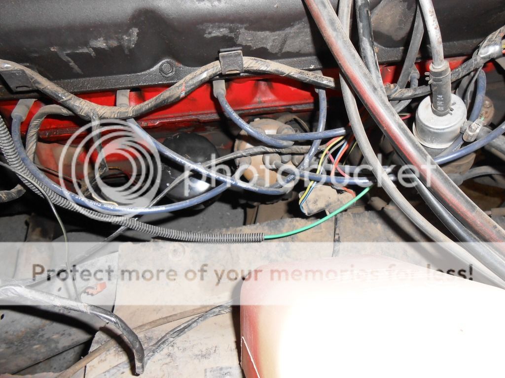

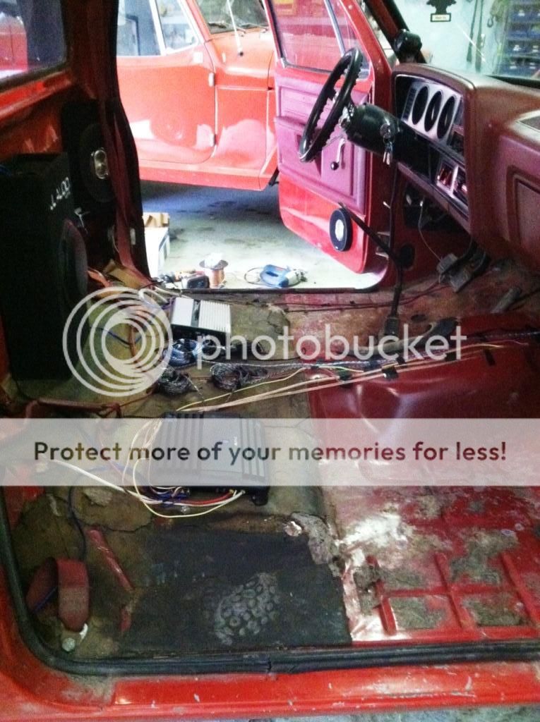

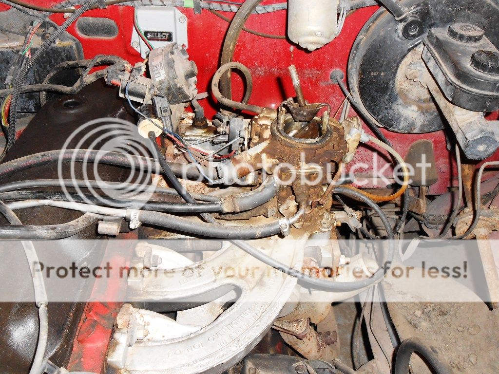

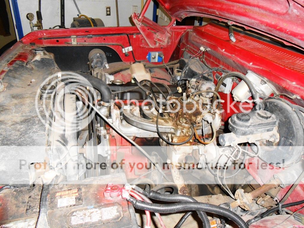

Here are some pictures of the my Son's pickup. The first phase of the project was to install a replacement stereo. Just turning 16 it gave him the opportunity to learn how to run wire, soldier, etc. My wife and I bought him a JL Amp and 8" sub for his 16th birthday, the rest he bought himself. We installed 6x9" Infinity Kappa speakers behind the seat in boxes we made and 6" component Infinity Kappa spekers in the doors. We made a plate to install the tweeters in place of the factory speaker in the dash.

Sounds like he is off to a good start!

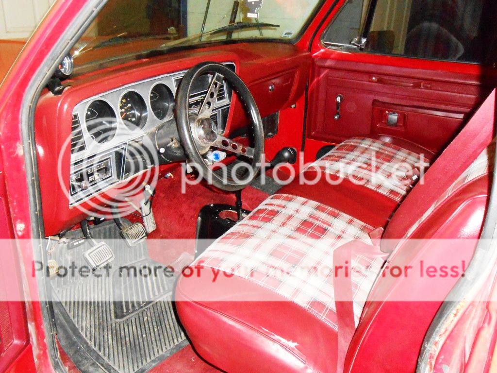

 Post subject: Interior
