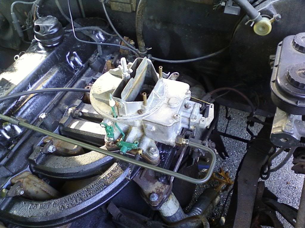

This is my setup, stock aluminum 1 barrel intake modded by cutting the flange off, opening up the hole, and screwing and epoxying a homemade adapter on. This is an Autolite 2100 but the mounting is the same for a Holley.
This requires a lot of fabrication and completely custom throttle and kickdown linkage.
Kevin

Kevin, the 64 thousand dollar question??????? How does it work? What would you do different on the next one?
If I was to do it again, I would buy and modify a 2 barrel spacer to fit instead of making my own ( way too much work for the money saved) and I would figure out a way to grind the intake surface flatter than I was able to get it with a hand grinder. I had some vacuum leak problems initially.
It seems to run fine although it is an ongoing project and not on the road yet. It starts easy, idles well, and has good throttle response.
