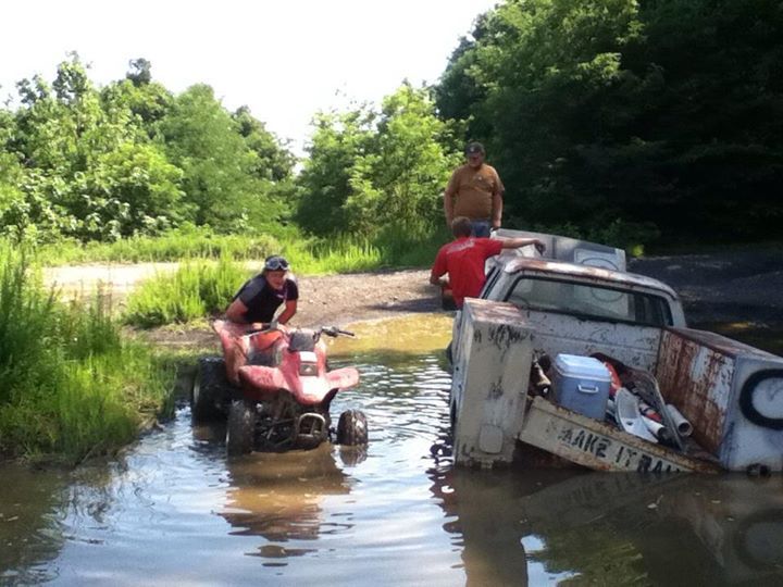

Back story, bought a 75 dodge w200 crew cab to swap the cab over to a cummins, decided the body was too rough so I figured I'd take the truck through some trails and see how it does. Did pretty good besides getting water in the carb and. killing it in a hole. Got it out started and finished the day. Brought it home went to start it to go back starter was out and when it would spin over no start. New plugs and starter =running better than when I bought it. Ran 30 min or so then knock knock knock. Assuming rod. Will post some pics and a video of the knock later.

Did you change the oil, gear oil and diff oil out after submersion? It's not optional after playing submarine. :lol:
Rod is most likely. Fix it before the crank is toast, or the rod windows the block.

To operate in water of that depth requires a lot of special work. In stock trim, your not going to want to put it deeper than ten or twelve inches, and operate at low speeds. The differentials will still need the hypoid changed after operation in even that shallow a depth.

And if you want to run in water that deep, you might consider a boat! :lol: :roll:
