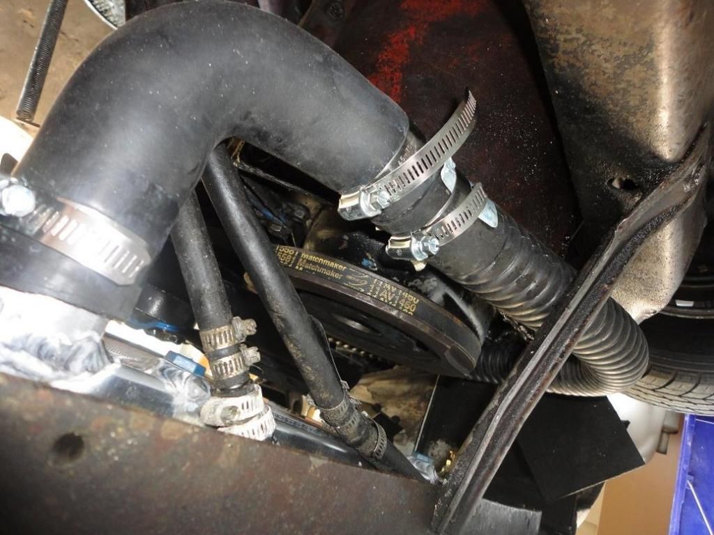

I was having a rough time finding a new radiator for my 63 Dart. Champion had a 64 radiator for a V8. Meaning the water pump inlet was on the driver side, instead of passenger side. So I went ahead and ordered one through Amazon. Finally I hear back from an email I sent Champion, and they told me that for an extra $60, they would place the inlet on the passenger side. But I had already ordered the other one. No biggie. I got a 30" flexible rubber hose. It reached quite a way, but I noticed no way would it do the 90 degree turn. Then it hit me - the upper radiator hose is an elbow. So then I had to find a barrel connector to connect the two radiator hoses together. I found it at JEGS. And all is good. I drove the car today - no leaks.
Having said that, if you have a 63 Dodge Dart, and need a new radiator, and don't mind an aluminum one, Champion has it. But they sell it as the 64 Dodge Dart. You will have to call them to get the inlet moved. Or do as I did, get the longer flex hose, connector, and extra upper hose.

There is my hose hookup. And the main reason for writing this up is because Champion doesn't advertise the option for the slant six for either the 63 or 64 model.

Awesome !!! It was worth the $60 compared to my setup. Be careful on the install. The flanges are real sharp, so when dropping it in place, you can easily get cut. You might want to feel them, and file them down once you get the radiator.
