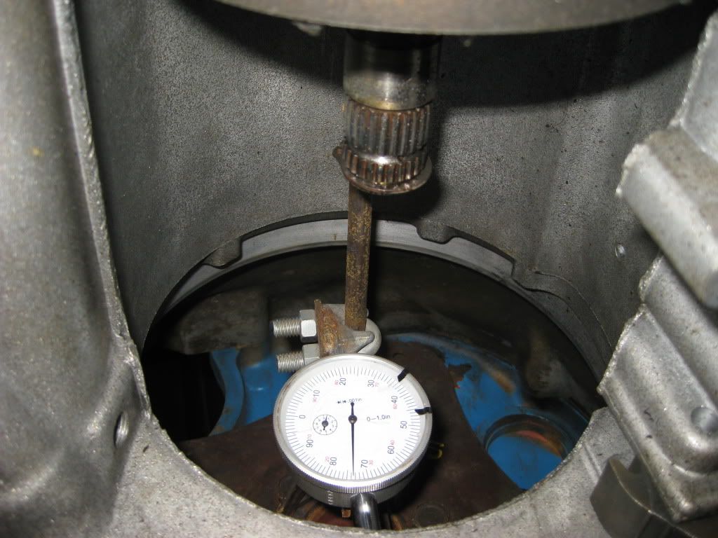

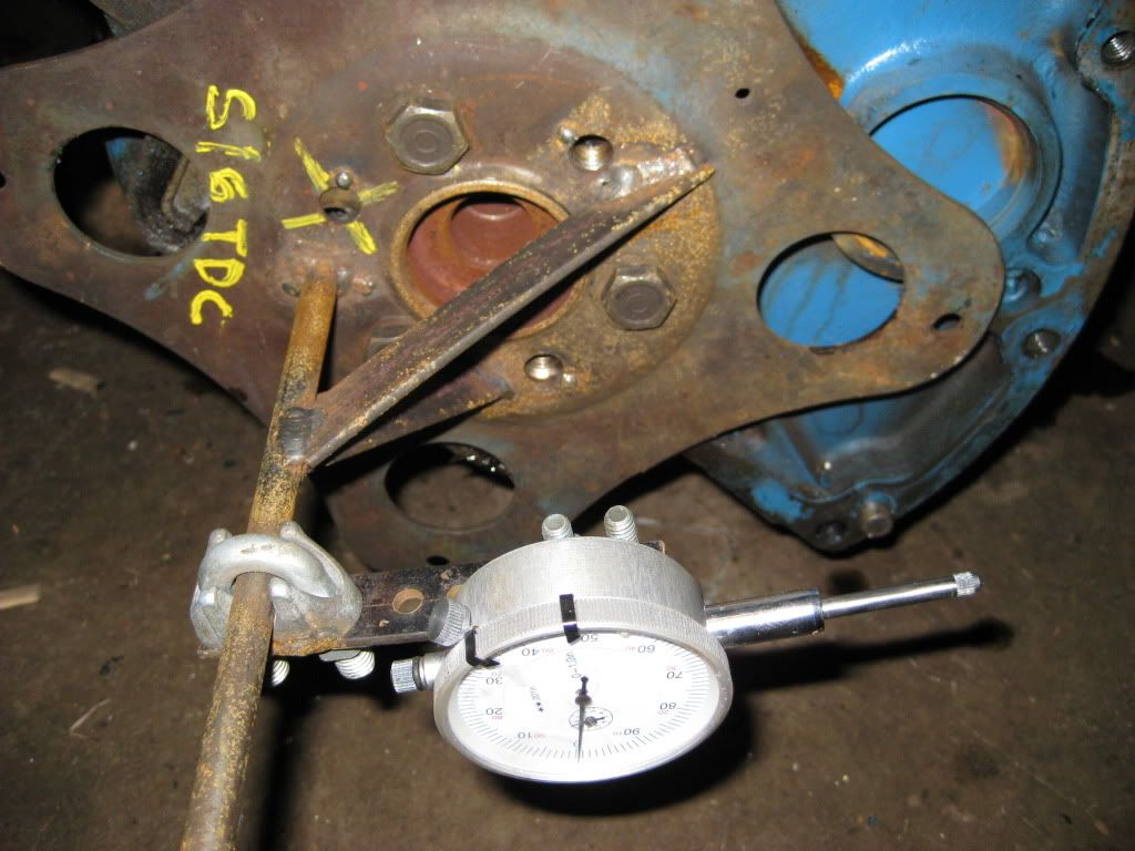

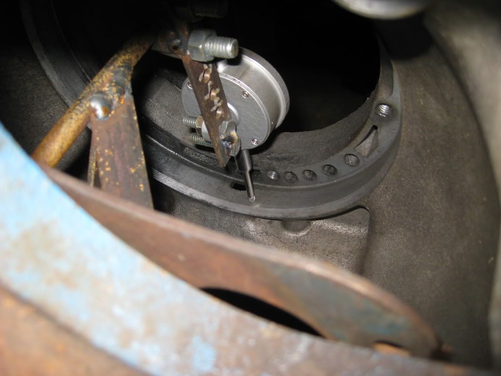

Have you tried contacting midland? maybe they will fix it under waranty.I also agree with lou,sometimes the alignment between the engine and trans can be very bad.The engine trans combo in my car was out by 0.035 (0.070 total indicator runout).Even with 0.021 offset dowels it was still out 0.030 TIR twice factory specs,but I used it anyway without a problem yet.If the converter snout is grooved,thats your culprit. Unfortunatly you have to strip the trans to the bare case to check it.ImageImageImage

You will feel vibrations when you rev it in neutral if off alignment. I broke 2-3 flexplates one summer...
