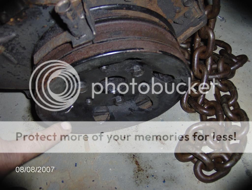

I dont mean too repeat posts but as long as its on my mind again.......I found out on another thread I have going here that I have an early dampner on my engine right now, evidently if I understood correctly it is pre-1980 cause it has several hash marks around its circumference, pictured here is the dampner that is on my 1984 spare engine.
Quote: To set the valve lash on pre-1980 engines that had solid lifters.
Maybe he didnt mean it was pre-1980, not sure
The one that is on my engine that is in my truck is a cast version, the area where I am pointing too here is cast and heavy looking. As you can see this 1984 dampner is a stamped steel version
Not sure how the engines are balanced but maybe its not going to make a difference, maybe I should be concerned and make the swap??

You're pointing to a stamped steel pulley which is bolted to the front of the damper. If you have a piston stop you can find true TDC and see how far off the marks on the damper are in relation to the timing tab.

My mistake again, I was confused because of all the lines on the dampner that is on my truck right now, I went by the line I should have been using.
I believe that now I have the correct timing mark and I will be able to get it timed closer. Thanks everyone for their help

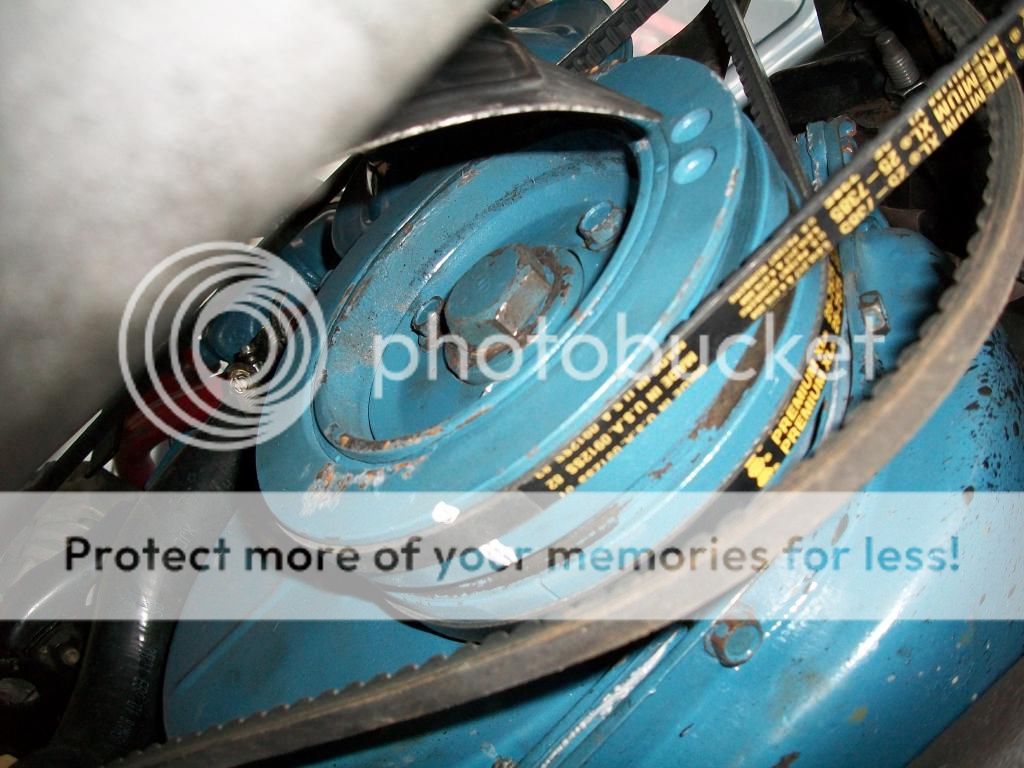

Attached is a picture of the dampner that is on my engine now, is this the incorrect dampner for my engine?
So if thats correct than this particular dampner was made with only two grooves and the third ( groove ) was added in the form of an extra pulley bolted too the front?

Im gonna check out how far things are off if at all once I am told which dampner is correct for my truck.
PostPosted: Wed Dec 25, 2013 4:33 pm
Passenger car and early engines of all kinds had the one pulley machined into the damper. If you had AC from the factory you got a pulley bolted to the back of the damper. If you had power steering you had a pulley bolted to the front. I don't know when big multi-groove damper came about, but someone here will.
 Post subject: late truck
PostPosted: Wed Dec 25, 2013 5:06 pm
It was in the late 70's...this damper is similar to the 440 damper, I have one of these style motors in my storage unit...so far I catch this style of damper on the trucks that were D-150's with the NP-435 4 speed and know of one that was on an industrial slant, although I have seen one that was transplanted into a 1974 Valiant in the junkyard (not original equipment...LOL).
-D.idiot
